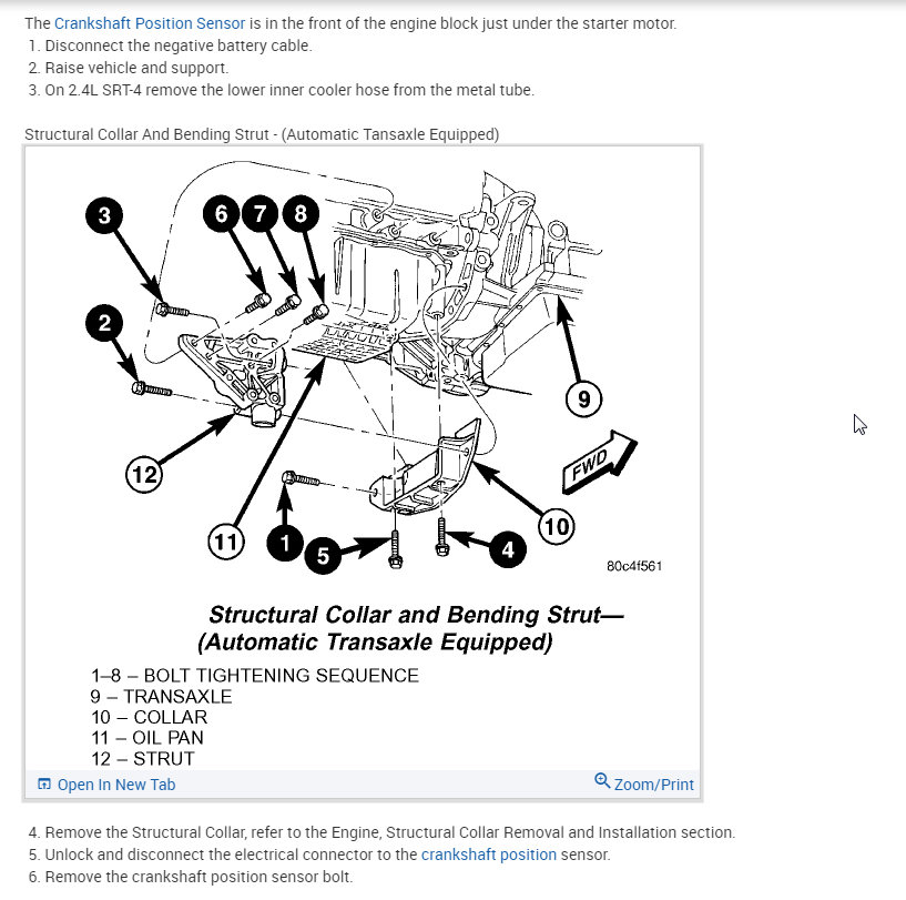

the car runs good when it is cold, but when it gets warmed up you will be driving and it starts cutting out like it is not getting gas.
Dec 4, 2019 at 12:50 AM

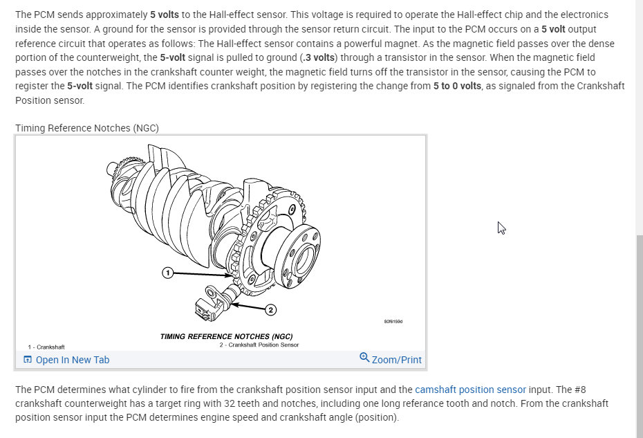

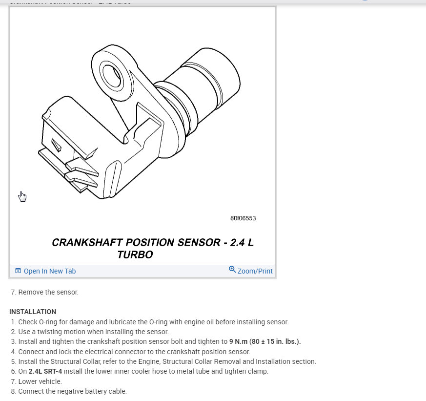

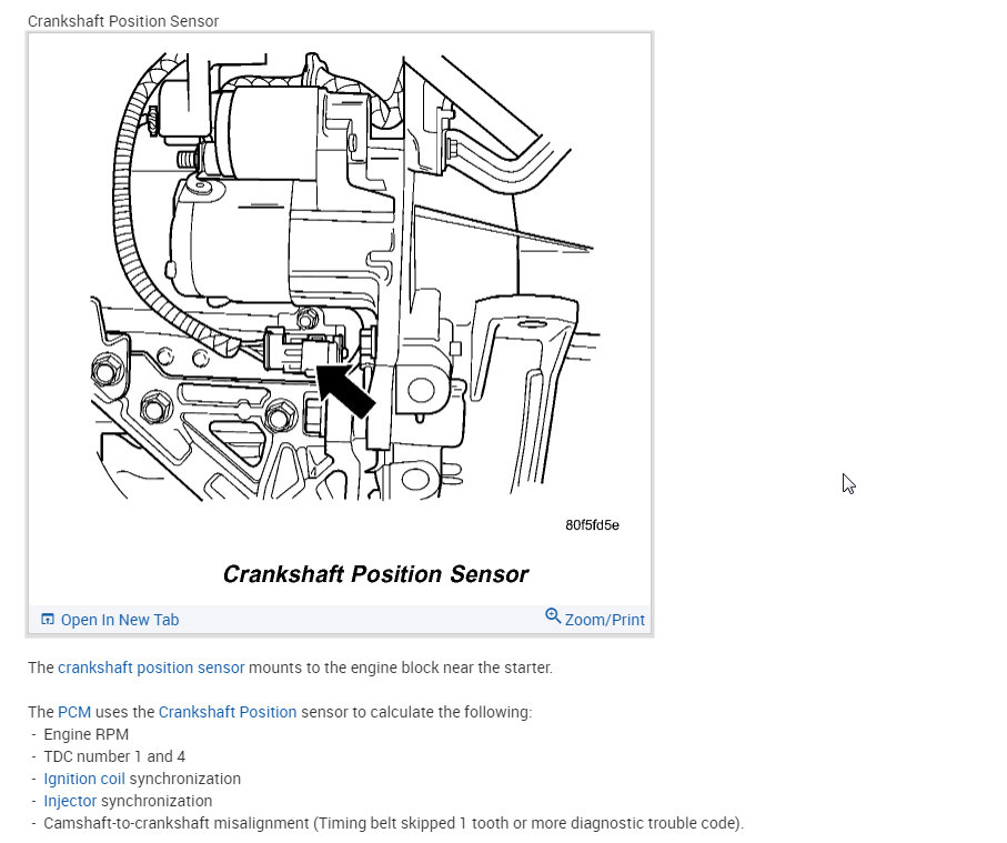

This could be a fuel pump cutting out but I want to clarify if the engine is completely cutting off when it get warm? If this is then it could also be a crank sensor.
Here is the guide to test the fuel pressure. I would suggest just hooking up a gauge and taping it to the windshield so you can see it when driving.
and
I attached the info about the crank sensor as well.
