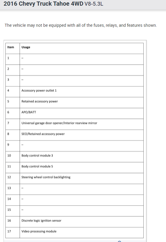

My mirrors will not move in or out. My driver seat will not move. Is there a fuse somewhere?
Sep 13, 2021 at 10:22 AM
SQM
  • 6,383 POSTS

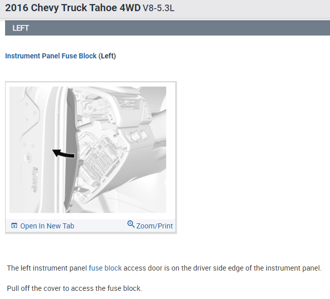

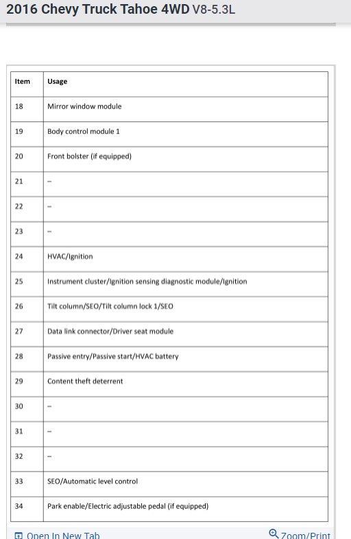

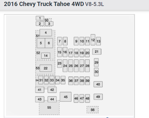

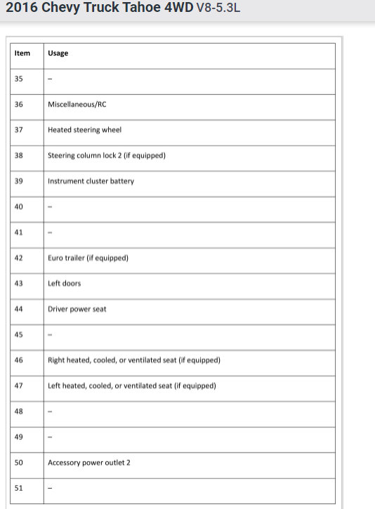

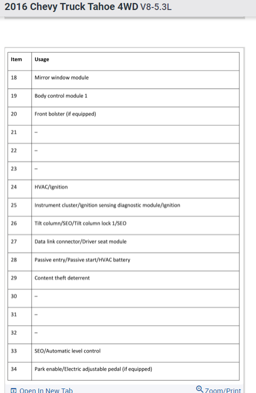

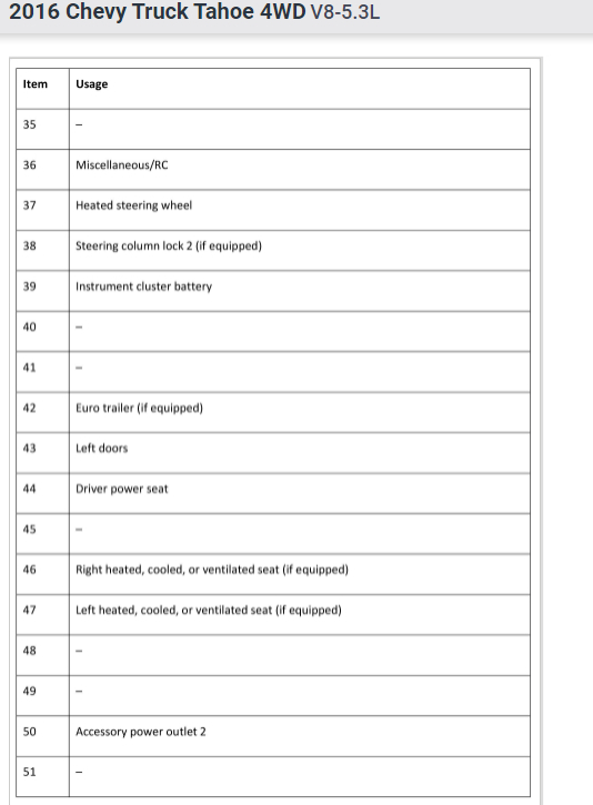

Any time you have an electric component inoperative the first item needs to be check is the fuse.
The fuses for those components are located in the fuse box at the left side of the dash (see diagram).
It should be fuse number 18 and 44.
Check those fuses.
Let me know if you have any questions.
