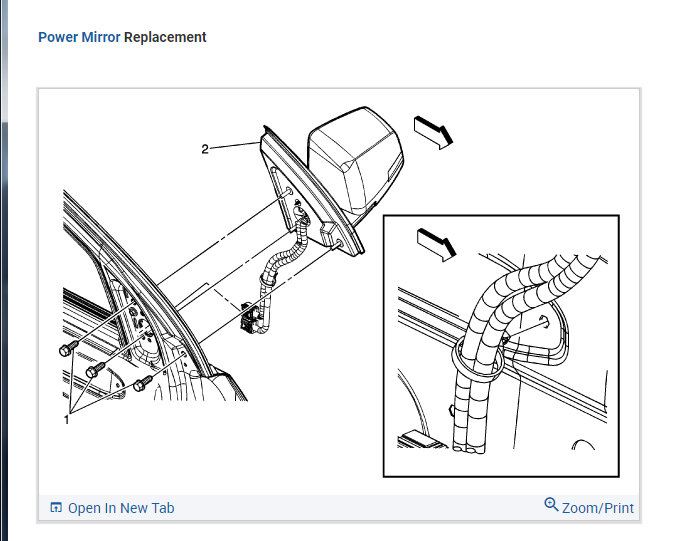

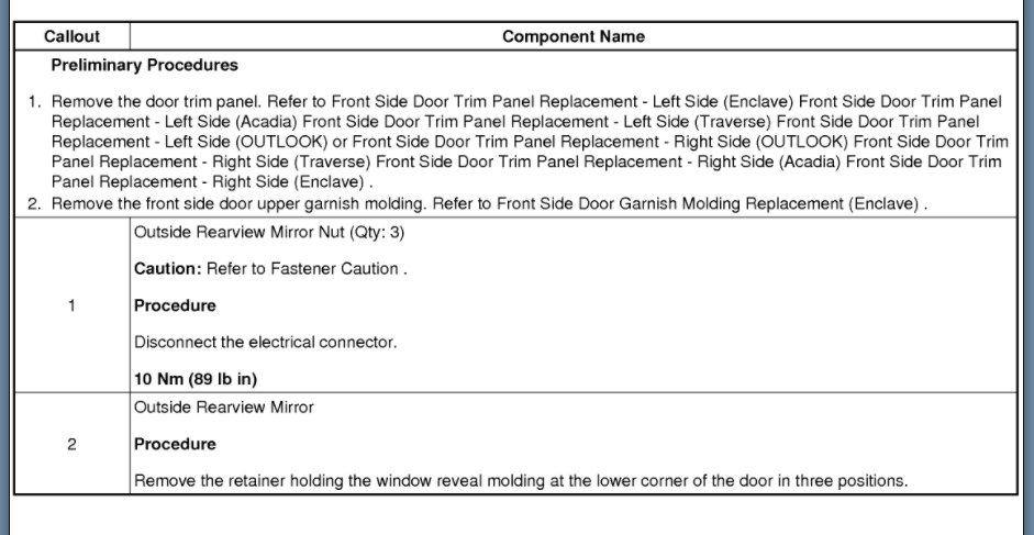

how much should I pay to have my passenger mirror replaced and I supply the part? Can I do it myself ?

This is something that most people can do themselves. If you are replacing the entire mirror then you just need to remove the door panel and remove the nuts holding it in place.
Here is a guide that will help with removing the door panel:
https://www.2carpros.com/articles/door-panel-removal
Also here is a video that shows how to do this:
https://youtu.be/-txa8XwWDRs
Lastly I attached the process below how to replace this mirror. Let us know what questions you have. Thanks
