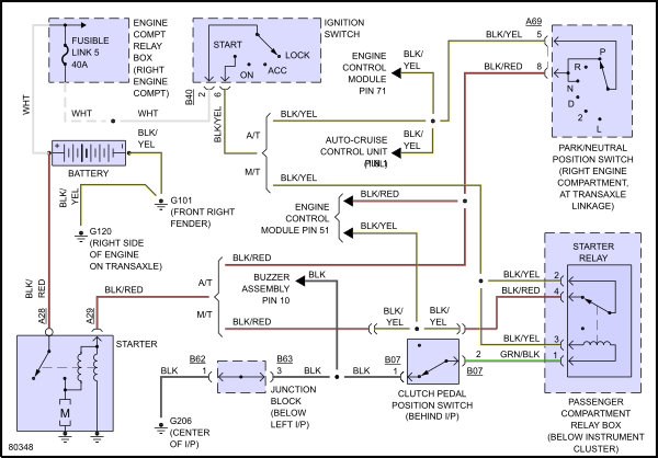

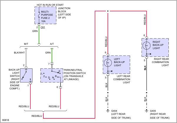

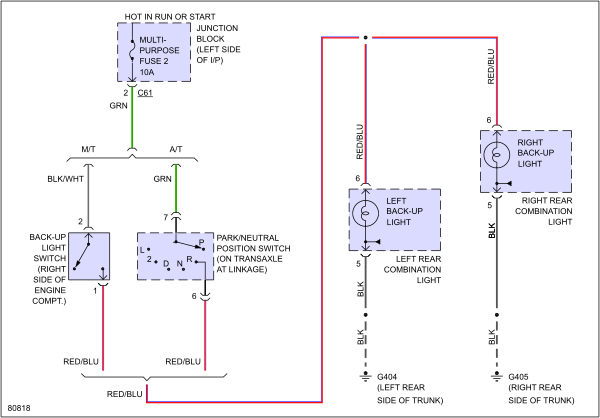

My mate has helped me do a automatic to manual conversion. the only thing i need to do now is bypass the inhibitor switch and the reverse switch pretty much all the electrical stuff, but i do not know any electricians so i do not know which cables to bridge. can anyone help?

Here are the schematics for the starting and exterior lighting systems for the Mirage. I have included both the manual and the automatic so you can compare the wires and connectors you have.

Correct me if im wrong but arent those pictures all automatic?

All pictures are for M/T and A/T.
For first 2 pictures, the Green and Red/Blue wires are needed for the backup switch.
