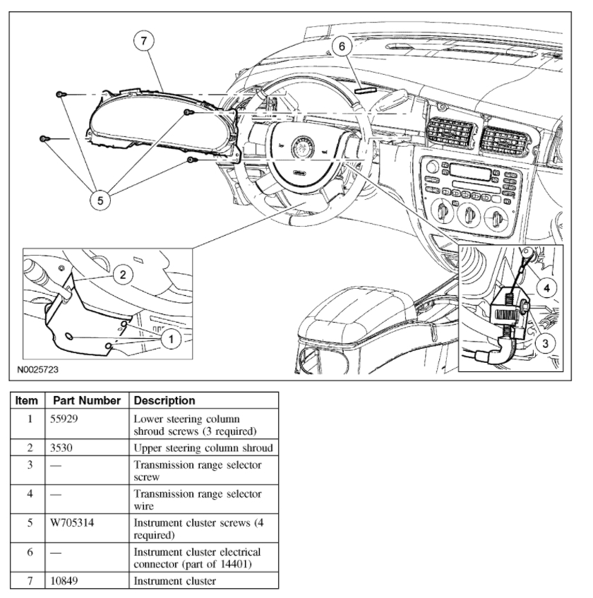

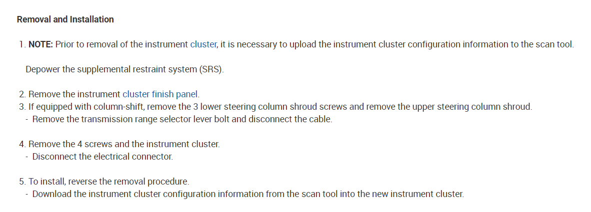

This video shows the job being done on a similar car but the process is the same. Here is a guide to help you step by step with instructions in the diagrams below to show you how on your car:
https://youtu.be/_HEC44xENxw
