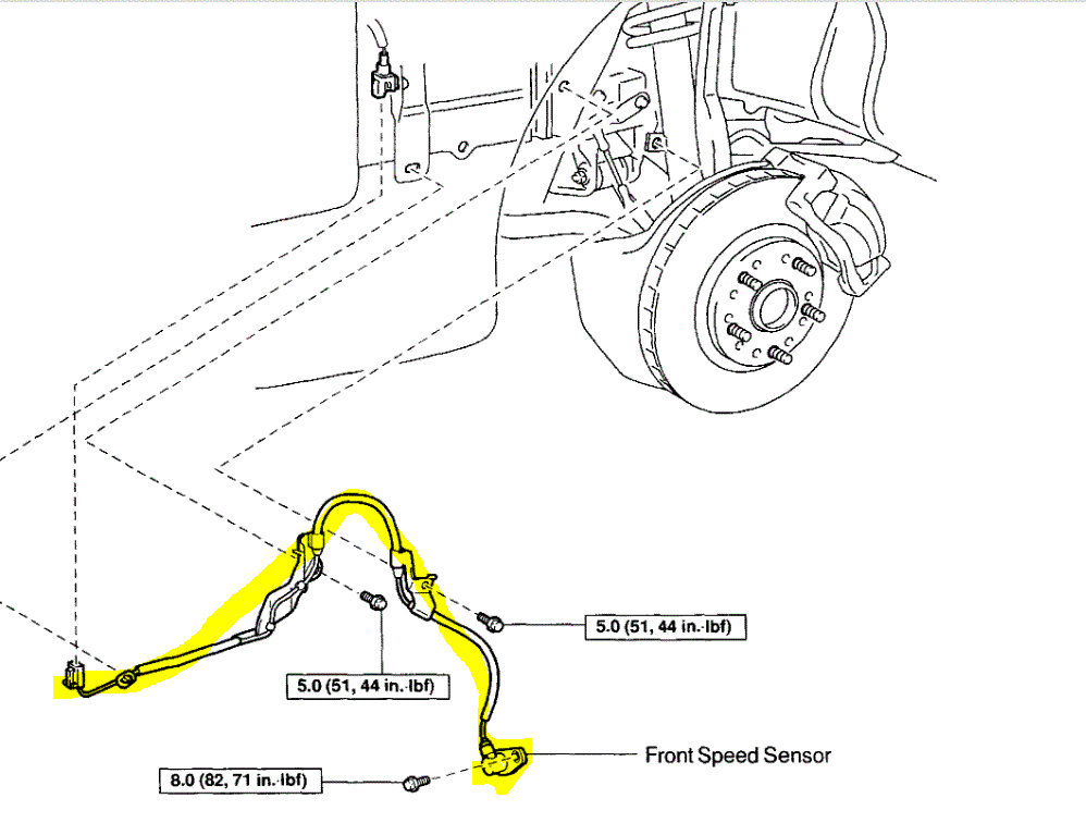

After my front left tire popped and was replaced we had a really bad freeze. I tried driving down the street to the store and ended up sliding backwards down a hill and getting stuck which ended up popping the tire I had just changed. Since having it replaced again, the sensor is still beeping and the brake light is on as if the tire is still flat and my miles per hour gauge isn't working. It also won't tell me how many miles I have left of gas. How do I fix this? Is there a wire that possibly came loose? And if I can't fix it myself how much is it going to cost to get it repaired?

Since it has the ABS light on as well, chances are the wheel speed sensor was damaged when you were stuck or from the flat.
Here is what I need you to check. Under the left front of the vehicle where the axle is located, you will see a wire going to the hub assembly.
I'm attaching the directions for replacement to help you locate and replace if needed. If you can't tell if it is damaged, follow this link. It explains how to test a wheel speed sensor.
https://www.2carpros.com/articles/abs-wheel-speed-sensor-test

SPEED SENSOR, FRONT
pic 1
COMPONENTS
- Replace the RH side by the same procedures with LH side.
1. REMOVE FRONT WHEEL
2. REMOVE FRONT FENDER LINER LH [53876A]
3. REMOVE SPEED SENSOR FRONT LH [89543]

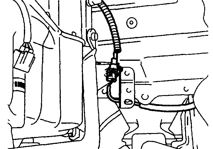

pic 2
(a)Disconnect the speed sensor connector.

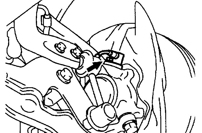

pic 3
(b)Remove the resin clip and 2 clamp bolts holding the sensor harness.
(c)Remove the bolt and speed sensor.
NOTICE: Do not stick any foreign matter on the sensor tip.

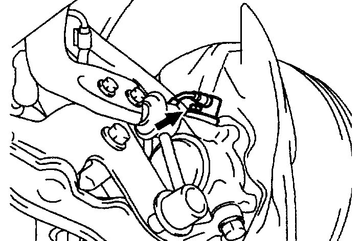

4. INSTALL SPEED SENSOR FRONT LH [89543]
pic 4
(a)Install the speed sensor with the bolt.
Torque: 8.0 Nm (82 kgf-cm, 71 inch lbs.)
(b)Install the sensor harness with the 2 clamp bolts and resin clip.
Torque: 5.0 Nm (51 kgf-cm, 44 inch lbs.)

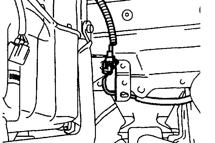

pic 5
(c)Connect the speed sensor connector.
