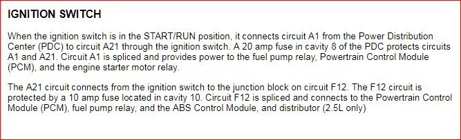

Car was stolen, pulled lock set so need to get odometer to light up for insurance mileage picture?

Okay, so the left the ignition, can it be wired and then have the key reset the cluster? Vehicle is drivable.

Ignition was cut off, shop was able to start and move inside and raise windows. Think the said only one or two cluster lights came on. I do have a replacement cluster I bought last year and didn't need as I was able to do several solder points to fix the original. So if I re attach the key switch (can I ?) and use new cluster to see miles ? Old one may be shorted out as most trim busted off instead of just removed.

Yes. You should be able to just wire the ignition switch back in and it should work. It is just acting as a simple switch that connects two circuits. As for the cluster, if you have another you should be able to just plug it in. This is an Electro Mechanical cluster which means it gets all its information from another source, mostly the BCM and it just displays what it is told.

Thank you very much. Was able to remove original cluster and install another and get the readings to light up. Now lets see if Adjuster will make a better offer. Yes, 1997 Sebring Convertible JX with 102,375 miles that was values at 136,000 miles and a pay out of $786.00 and keep the car. Shop estimates (loaded I think = $3,175) to repair. Value came from Kelly Blue Book evaluation. Is there any use in having a Attorney contact - Insurer says standing firm. Again - Thank you - on the way to find coulomb and dash parts and carry one key to start and one to unlock ! Wife says lock it, I say why, if they want it an ink pin will slit the top or entry. Who's right? lol
