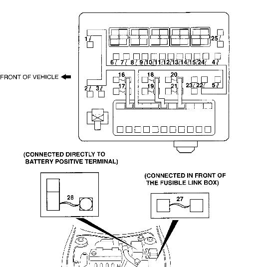

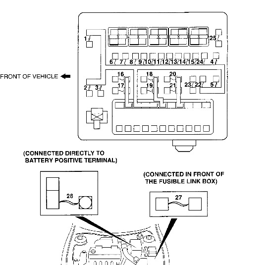

What fuse is #25? No owners manual and have been looking for diagrams but no luck.
Apr 28, 2013 at 2:30 PM
HMAC300
  • 48,601 POSTS
it's underhood and for the defroster
Apr 28, 2013 at 3:26 PM
GINAB74
Yes I see it's under the hood. The pictured diagram you are showing is not the same. Thanks
Apr 28, 2013 at 3:41 PM
GINAB74
It's not a convertible or coupe.
Apr 28, 2013 at 3:42 PM
HMAC300
  • 48,601 POSTS
that's what we show in the book it in the underhood box.
Apr 28, 2013 at 3:44 PM
GINAB74
Yes it's in the fuse box under the hood. It's 25. It's a 20amp. I've had to replace it twice today because the car wouldn't start. The fuse was not blown but the car started by just replacing it. I just don't know what it could be. I'm assuming whatever it controls is going bad as after several starts I have to replace it.
Apr 28, 2013 at 3:49 PM
HMAC300
  • 48,601 POSTS
fuse 25 goes to the engine control module which powers the asd relay. you might check to seeif the relay is bad by changing with a like relay and see if it cures the problem. if not you'll have to have it scanned as the pcm may be going bad.
