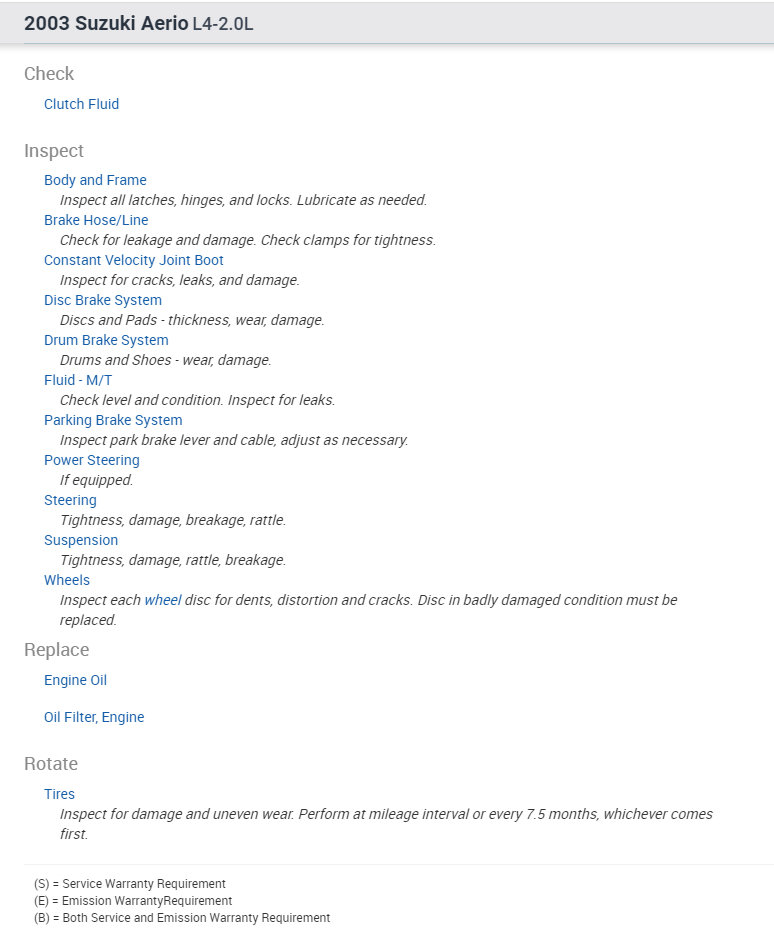

For a 2003 vehicle that is low mileage.
I have attached the recommender service at that mileage for your reference.
https://www.2carpros.com/articles/how-to-change-engine-oil-and-filter
Let me know if you have any specific questions or concerns.
