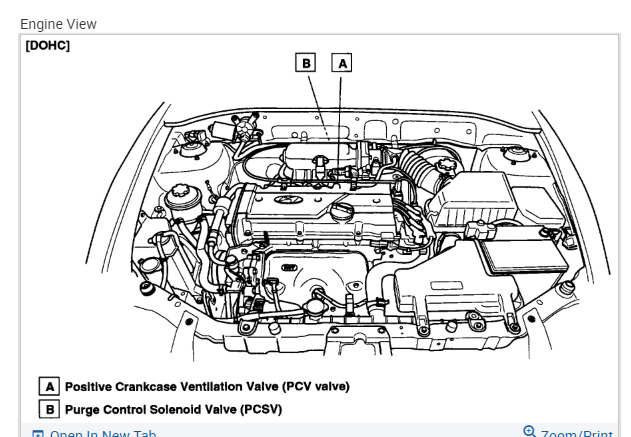

i bought the vehicle listed above GLE model in April 2020.
Then i filled 13 liters of oil in tank but in 13 liter car run only 50 km.
Then again i fill only 2 liter petrol and car run only 9 km and then start again car not start.
Once again i fill 2 liter petrol but this time car run 25 km... Without any stoppage.. Car continues run .. Again car stop.
Car not start after 2 hours.
Please advice me what can i do now.
Jul 20, 2020 at 8:46 PM

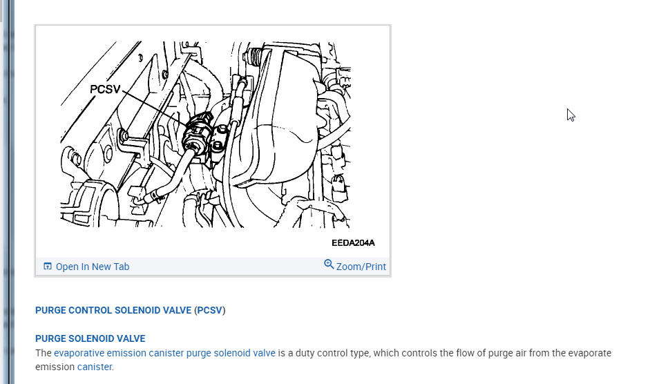

This sounds like your issue happens after you put fuel in the vehicle. If that is the case then most likely you have a faulty purge control valve and possibly raw fuel in the charcoal canister. This is what causes the valve to fail so I attached the info for this. Let me know what questions you have but this valve is responsible for allowing vapor from the tank into the engine so that it is not omitted to the atmosphere.
Here is a guide that talks about other common causes of a stall:
https://www.2carpros.com/articles/engine-stalls
I attached the info about the purge. Let me know what questions you have and we can go from there. Thanks
