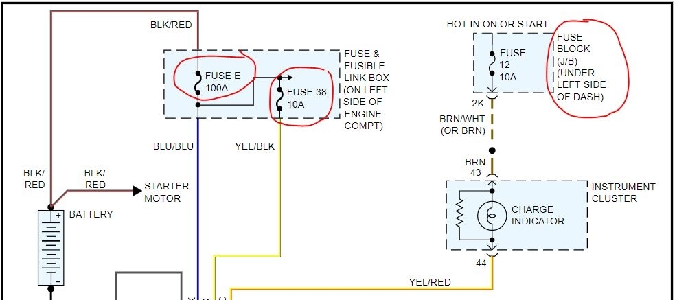

Car runs, no horn,no power windows,no wipers, not charging,etc. please help me.

First, I want you to check the fuses I have circled in the picture below. Make sure they are good and the circuit is getting power.
Here are a few links you may find helpful:
Let me know what you find.
