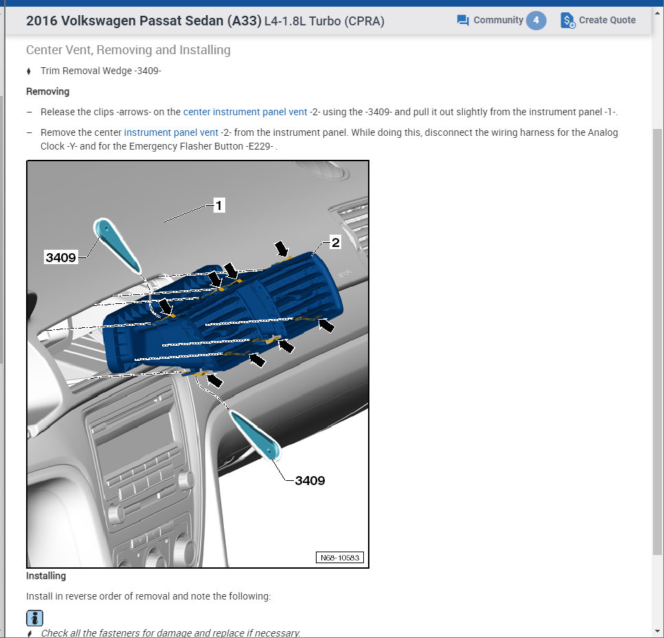

Middle air vents not blowing any air.
did a reset on the actuator but that didn"t solve the problem, the air is set for dash vents but only the 2 side vents are working and the remaining air blows towards the foot area

https://www.2carpros.com/articles/low-or-no-air-flow-from-vents
I am attaching the info below on how to remove the center vents and then you should have a better view as to what is happening to the door. If you can't see it use a mirror or borescope to see inside the box to find out why the air is not coming out the center vents.
Please run through this and let me know what you find.
