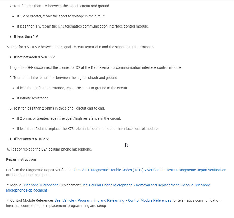

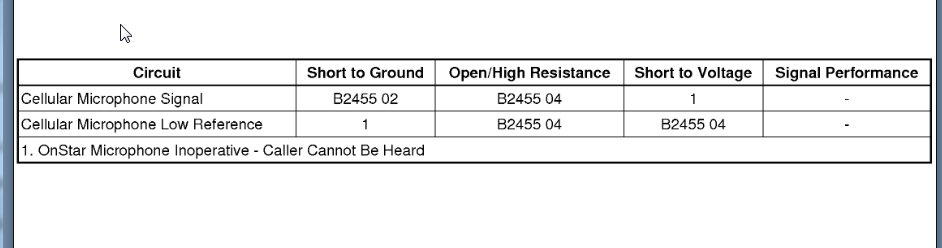

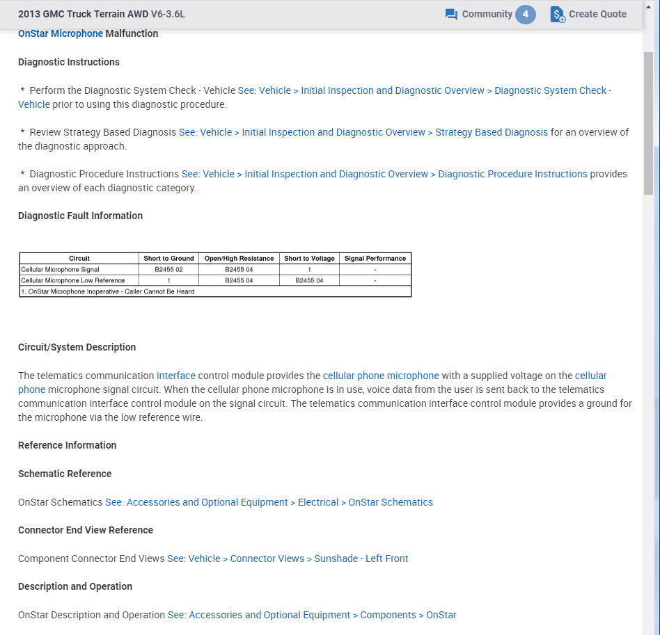

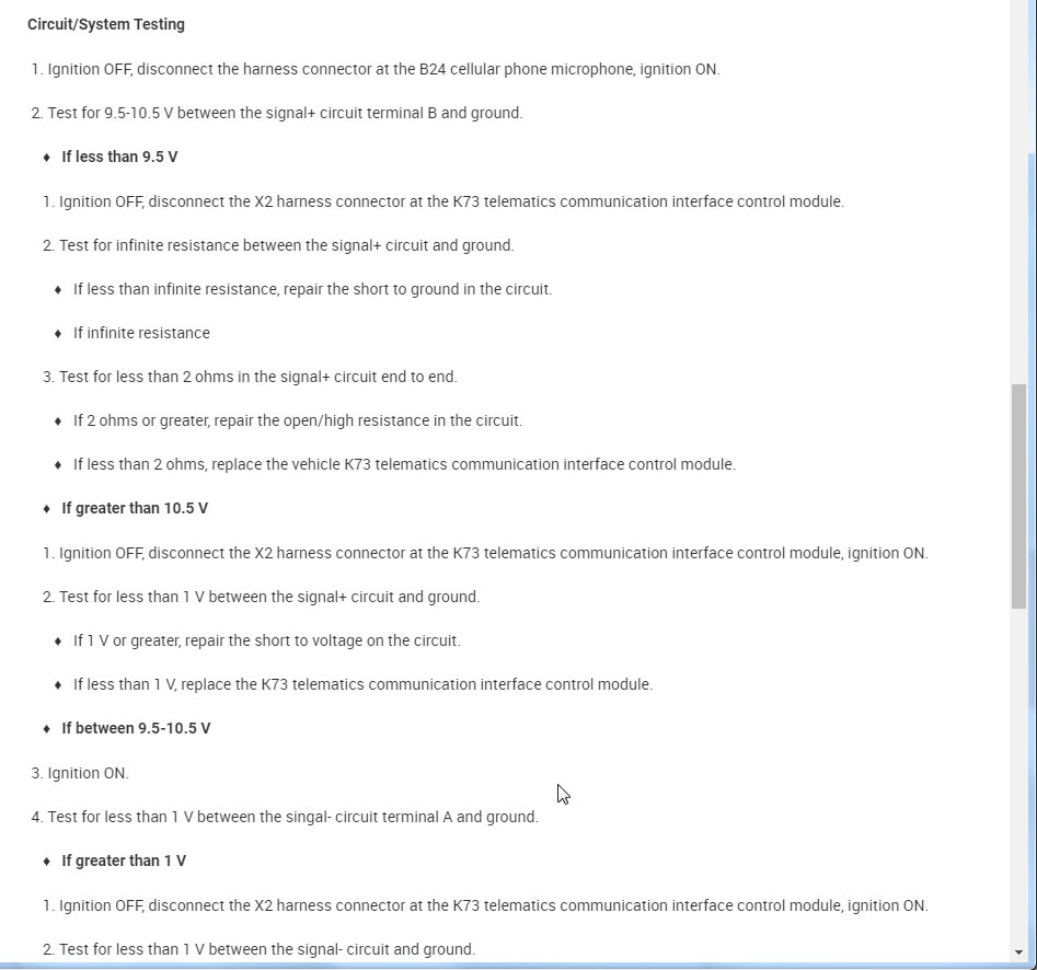

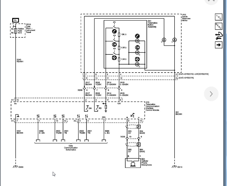

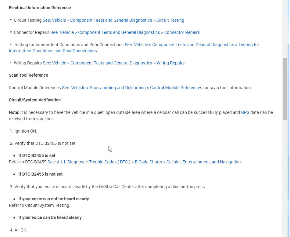

So I can assume you have a wiring issue, but here is the test that you need to run through to locate the issue.
Run through this and let me know what you find. Thanks

Before going through those steps I would recommend disconnecting the battery for 10 minutes. Sometimes this will reboot the telematics. If you still have an issue with the microphone then proceed with the fault trace outlined by KASEKENNY1.
