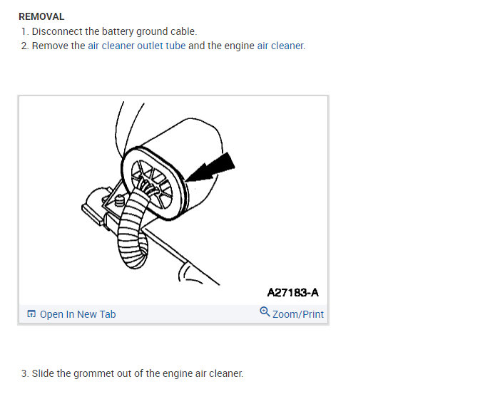

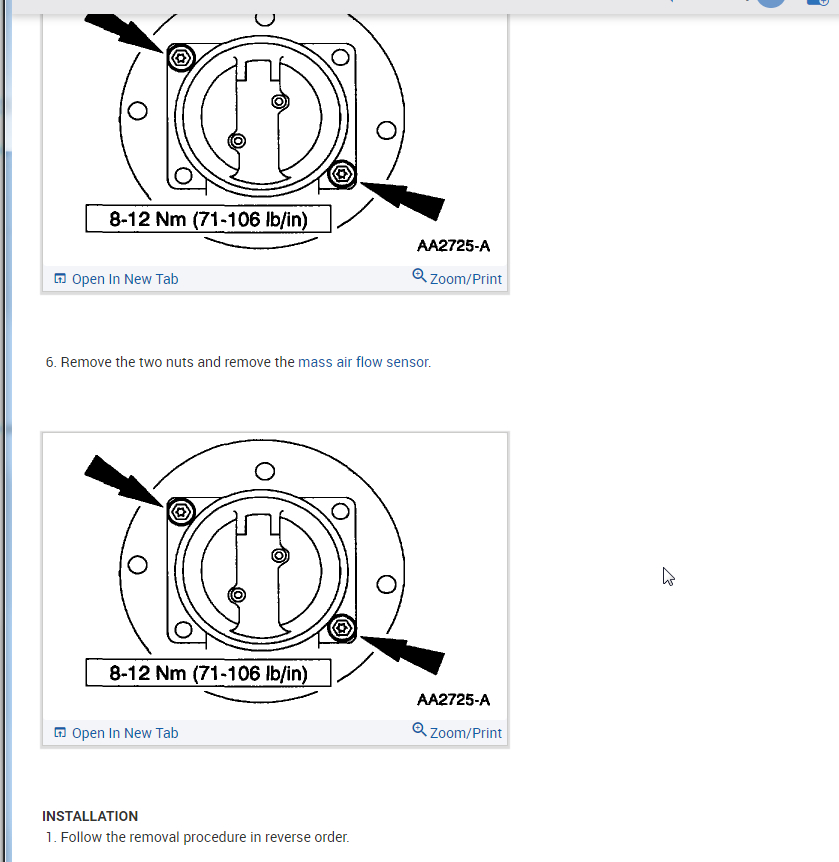

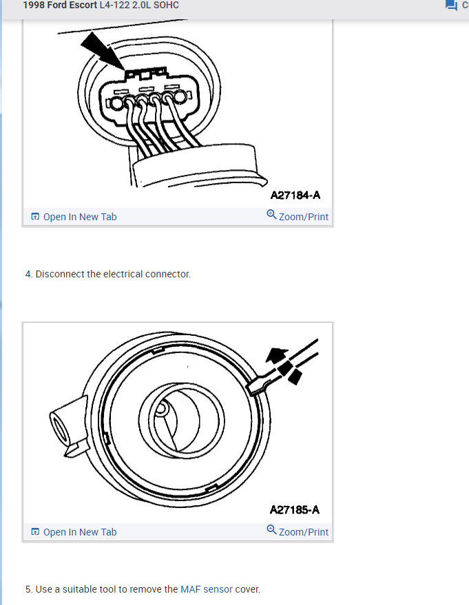

When you cleaned the MAF did you follow this process?
https://www.2carpros.com/articles/mass-air-flow-service
If not, I suspect the sensor is damaged and not reading the air properly that is coming into the engine. If this is all that you did, I would start with checking for codes and then replace the MAF if nothing else comes up.
