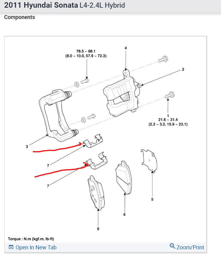

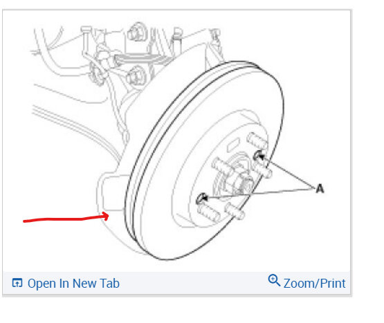

It sounds like one of the brake disc dust shields is contacting the rotor, I would raise the front of the car and spin the wheels to see which one is making the noise. Can you please shoot a quick video with your phone so I can hear the noise? That way I can tell for sure what's going on. You can upload it here with your response.
