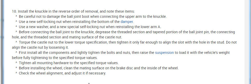

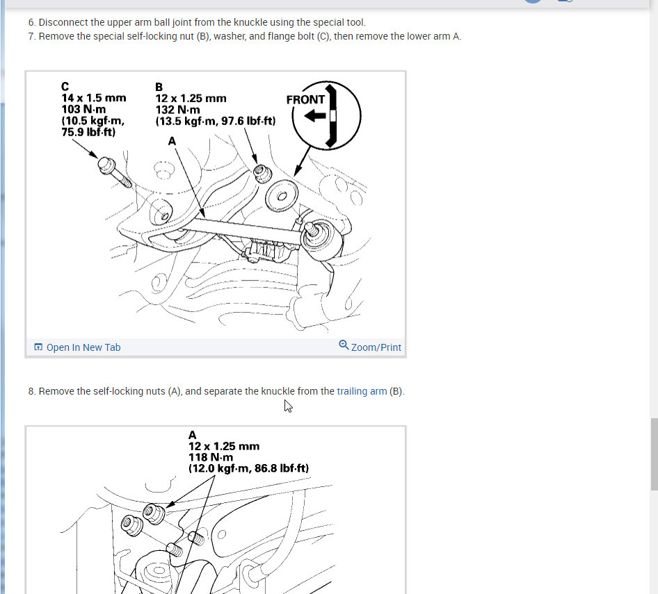

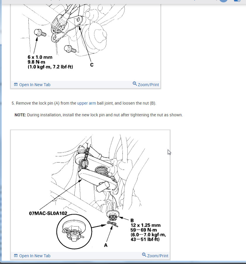

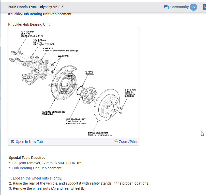

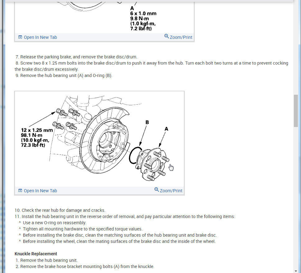

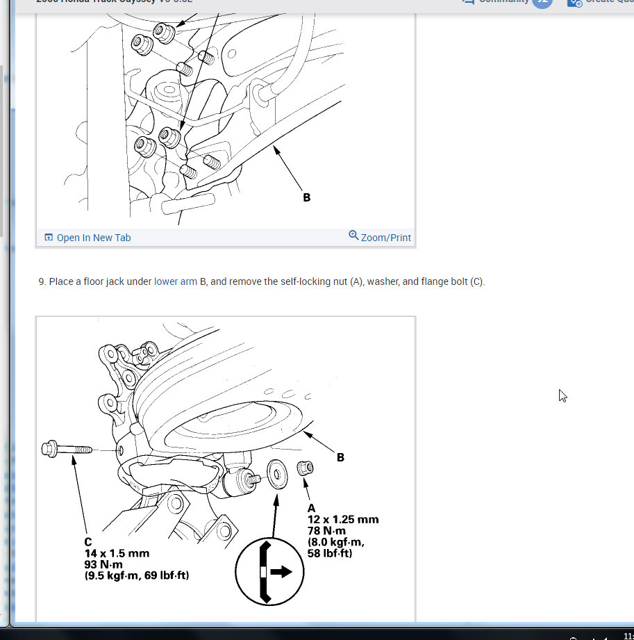

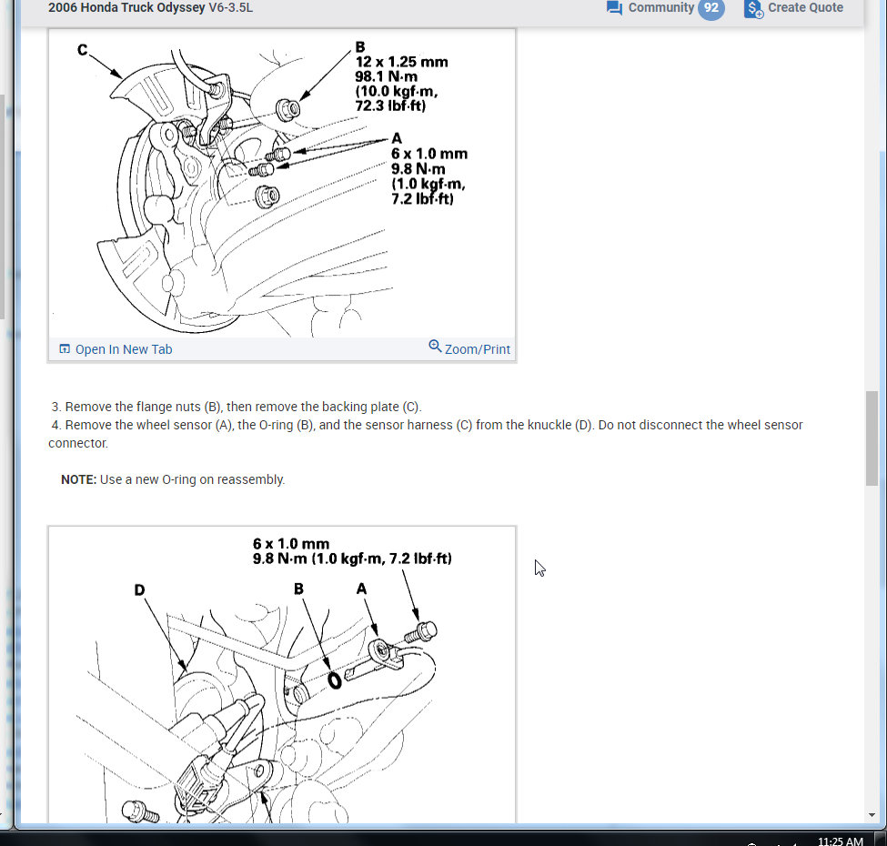

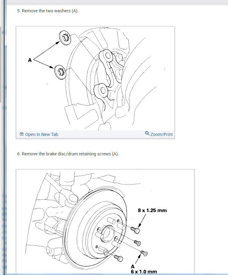

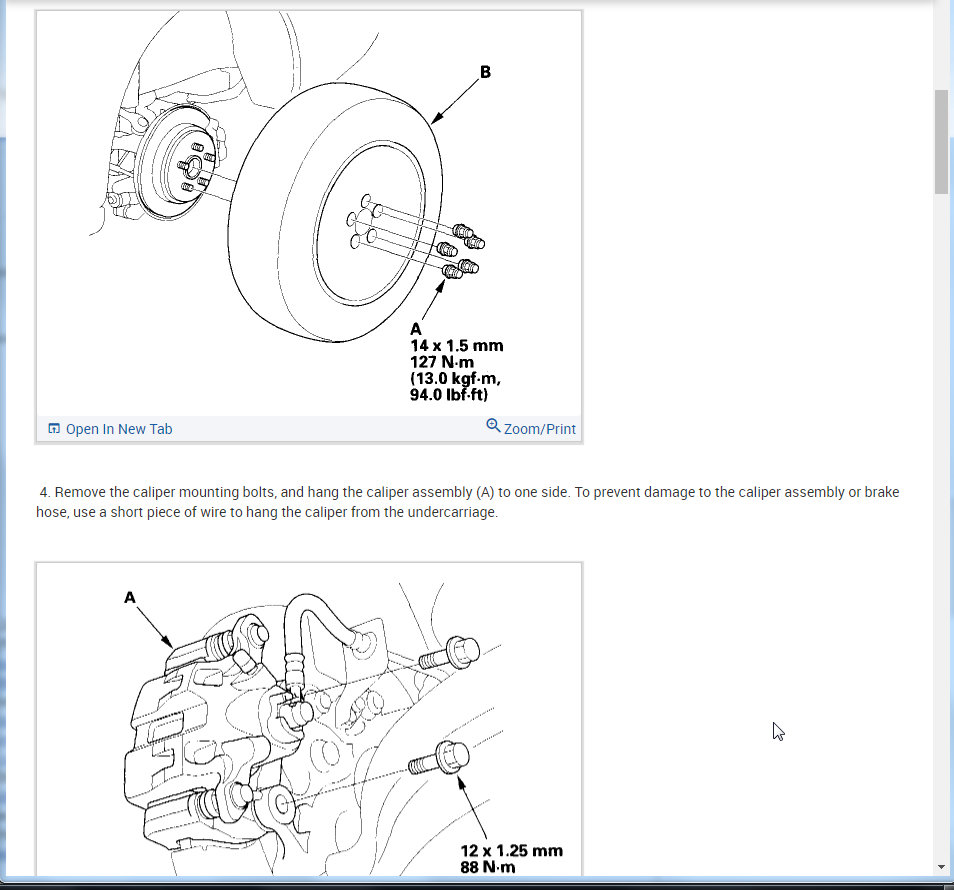

This is most certainly a wheel bearing issue so here is the procedure on how to replace it. If the noise gets worse when you are in a turn that is indicative of a bearing failure. Then when you remove the load or weight from the bearing it will quiet down.
If it were me, I would disassemble the wheel and just check the brakes to rule them out for sure and then replace the bearing.
Let us know what questions you have. Thanks
https://www.2carpros.com/articles/how-to-replace-front-wheel-bearings-and-seals
