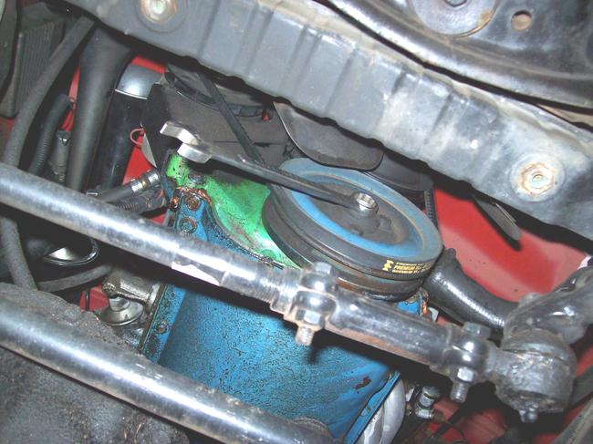

SENDING A PIC OF TURNING THE CRANK WITH A WRENCH...........THIS IS MY '77 JEEP CJ5
