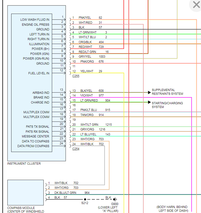

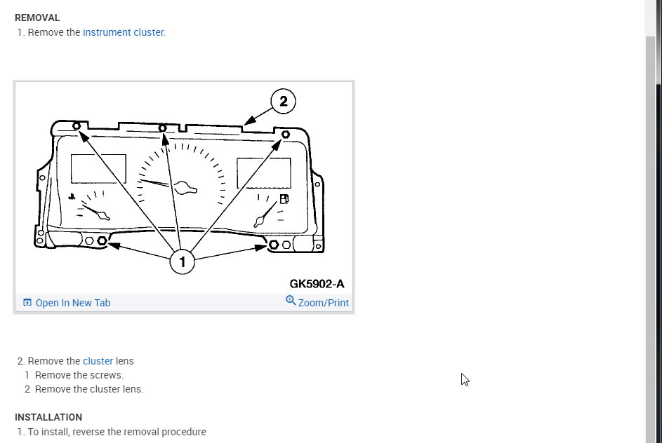

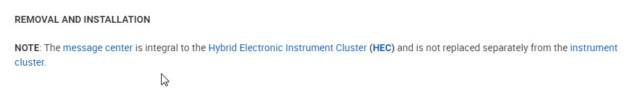

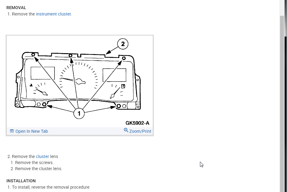

Message center was working fine, and one day while I was driving the display stopped working. I’ve checked the fuses and couldn’t find any blown. Any ideas?
Nov 28, 2019 at 3:09 AM
Unfortunately, this message center is part of the cluster and cannot be serviced separate. Take a look at the attachments. You will need to replace the cluster if it is not working.
Let me know if you have questions.
