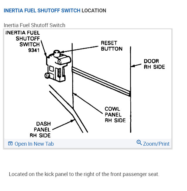

i drove my car to the store came out went to start it it turned over but would not start it seemed like it wanted to but wasnt getting gas i checked the fuel pump fuse replaced the fuel pump relay fuse but it still wont start the guy at the auto parts store told me ther was a red override reset switch that might need to be reset but i looked every where and couldnt find it do you know where it is located and if its not that reset button what should i check next

Your inertia fuel cut switch is located behind left side of dash, above kick panel
https://images.2carpros.com/forum/automotive_pictures/12900_inertia_switch_6.jpg

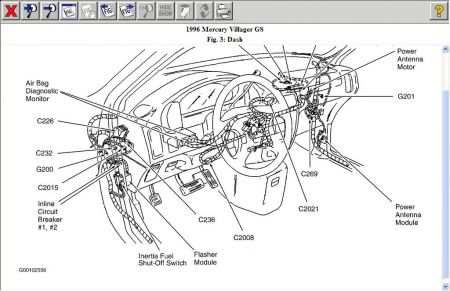

Under dash, right side next to the kick panel. Look for the red button. Push it to reset the fuel pump. Check out the diagrams (Below). Please let us know if you need anything else to get the problem fixed.
