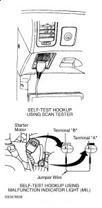

where do you hook up a diagnostic tester to this car?

DLC is located behind the left side of the instrument panel, below the fuse / relay panel.
