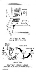

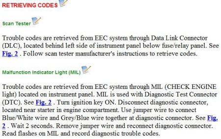

Where is the obd hook up located on this van?

https://images.2carpros.com/forum/automotive_pictures/55316_94villagerobd_1.jpg
https://images.2carpros.com/forum/automotive_pictures/55316_94villagerobd_2.jpg
