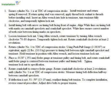

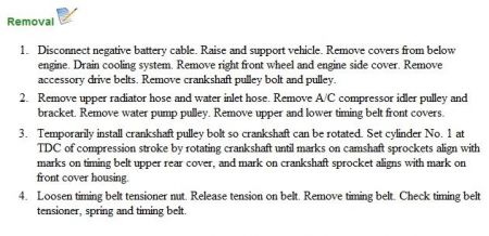

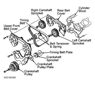

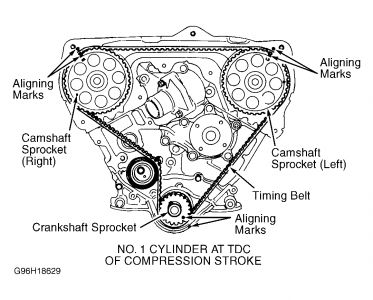

Hello i'm not a proffessional in mechanic but i wanna try to change the timing belt but i don't know how to check the timing, could you help me how to check the timing on a 93 Mercury Villager Van, i'll be thankful

https://images.2carpros.com/forum/automotive_pictures/261618_Noname_1912.jpg
https://images.2carpros.com/forum/automotive_pictures/261618_Noname2_614.jpg
https://images.2carpros.com/forum/automotive_pictures/261618_Graphic_409.jpg
https://images.2carpros.com/forum/automotive_pictures/261618_Graphic2_60.jpg
