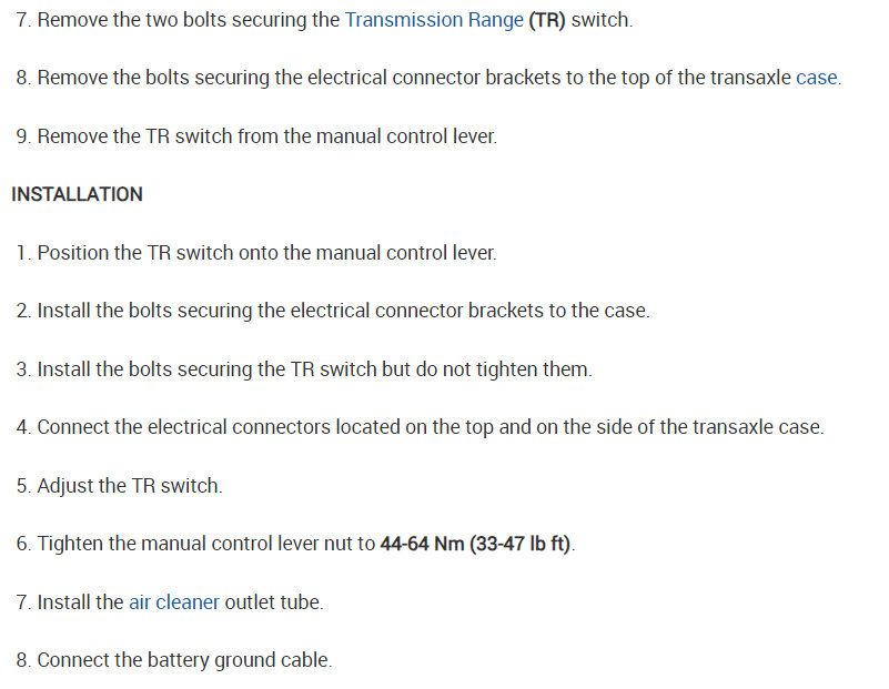

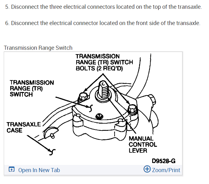

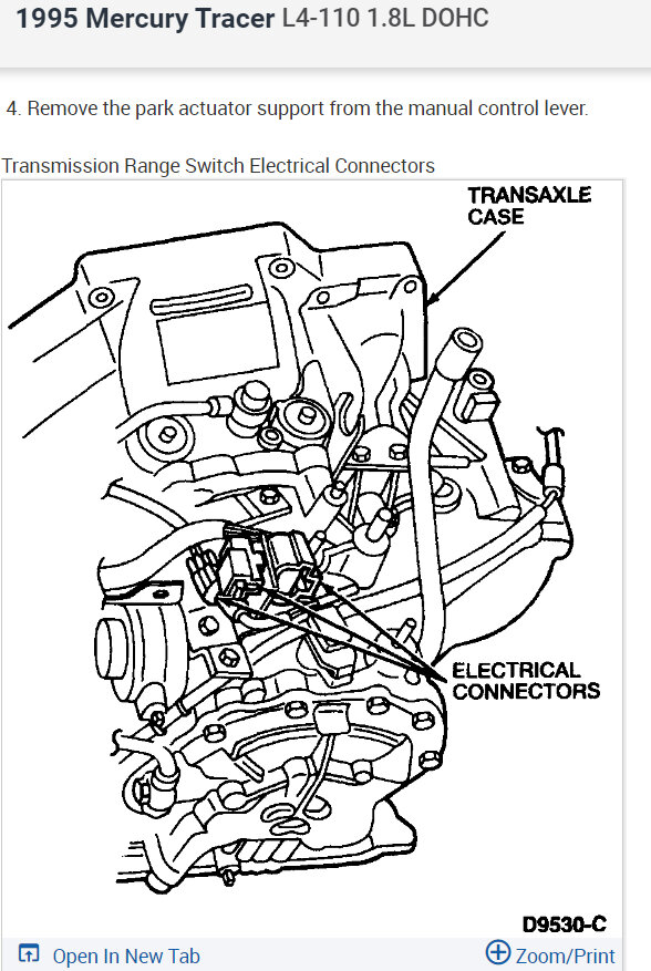

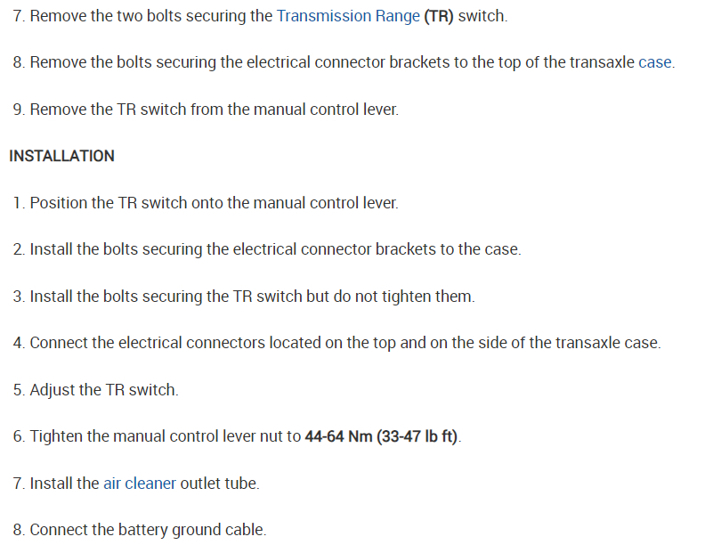

This guide can help because it sounds like the neutral safety switch has gone bad.
