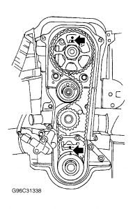

I am changing the timing belt on my 99 tracer and do not know where the timing marks are. The car is 2.0 l engine with single overhead cam. If you could please help me learn how to change the belt or at least find the timing marks. Thank you.

Hi Thersa, Below is the diiagram for the timing marks. Just remamber that the Number 1 Cylinder has to be at Top Dead Center on the Compression Stroke.
https://images.2carpros.com/forum/automotive_pictures/188069_99tracertimingmarks_1.jpg
