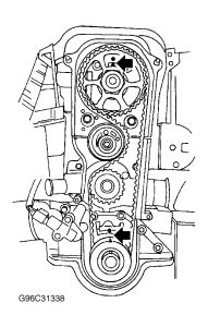

How do you retime the engine before putting the belt on?

Hi there, Engine timing marks as per pic. mark (mhpautos)
https://images.2carpros.com/forum/automotive_pictures/61395_merc_2.jpg
