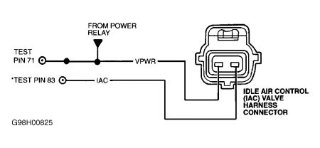

I ran one more test.. I disconnected the power to the IAC, the used one and put one of the multimeter probes on one of the IAC terminals and the other one the IAC body per the instructions found in a repair book. The reading was 1, I reversed the polarity and still reads 1.. I tried this out with the other two IAC's and again it reads 1. I tried this on all resistance settings starting from lowest all the way up to highest? The repair book said I should be reading at least 10,000 ohms?

MERLIN2021
  • 17,250 POSTS
https://images.2carpros.com/forum/automotive_pictures/62217_Tracer_1.jpg
TESTS W/CODES (SOHC) -1998 Mercury Tracer GS Page 1 of 5 Diagnostic Aids Perform this test when instructed during QUICK TEST or if directed by other test procedures. This test is used to diagnose the following:  Throttle linkage.  Wiring harness circuits (IAC and VPWR).  Faulty Idle Air Control (IAC) valve.  Faulty throttle body.  Faulty Powertrain Control Module (PCM). Fig. 52: Identifying IAC Circuit & Connector Terminals 1) Check For DTCs Retrieve and record all Continuous Memory DTCs. Perform KOER ON-DEMAND SELF-TEST . If DTC P0505, P1504 or P1507 is present, go to next step. If DTC P0505 or P1507 is not present, IAC system is okay and testing is complete. If symptom exists, go to TESTS W/O CODES - EEC-V article. 2) DTC P0505, P1504 & P1507 DTCs P0505 and P1504 indicate IAC system malfunction has been detected. DTC P1507 indicates that IAC system under speed fault has been detected. Possible causes are:  IAC circuit open or shorted to PWR.  VPWR circuit open.  Contaminated IAC valve assembly.  Damaged throttle body.  Faulty IAC valve.  Faulty PCM. Turn ignition off. Disconnect IAC valve connector. Turn ignition on. Measure voltage between VPWR terminal at IAC valve wiring harness connector and battery ground terminal. If voltage is more than 10.5 volts, go to next step. If voltage is 10.5 volts or less, repair open in VPWR circuit. 3) Check IAC Valve Resistance Turn ignition off. Connect DVOM positive lead to VPWR terminal at IAC valve. Connect DVOM negative lead to IAC terminal at IAC valve. If resistance is 6-13 ohms, go to next step. If resistance is not 6-13 ohms, replace IAC valve assembly. 4) Check IAC Valve Internal Short To Case Turn ignition off. Measure resistance between each IAC valve terminal and IAC housing. If both resistance readings are more than 10,000 ohms, go to next step. If any resistance reading is 10,000 ohms or less, replace IAC valve assembly. 1/29/2009 TESTS W/CODES (SOHC) -1998 Mercury Tracer GS Page 2 of 5 5) Check Air Inlet System Turn ignition off. Remove air filter. Inspect air filter, MAF sensor and air inlet system for excessive dirt or contamination. Repair as necessary. If air inlet system is okay, go to next step. 6) Check For Vacuum Leaks Start engine and allow to idle. Inspect air inlet system any of the following possible faults:  Cracked or punctured air inlet tube.  Loose inlet air tube or air cleaner housing.  Loose or damaged throttle body.  Contaminated or damaged IAC valve assembly.  Faulty EGR valve or gasket.  Faulty PCV valve or hose. Check entire system for vacuum leaks. Repair as necessary. If no vacuum leaks are found, go to next step. 7) Check IAC Circuit Continuity Turn ignition off. Disconnect PCM 104-pin connector. Inspect connector for loose, damaged or corroded terminals. Repair as necessary. Install Breakout Box (014-00950), leaving PCM disconnected. Measure resistance between breakout box test pin No. 83 (IAC) and IAC terminal at IAC valve wiring harness connector. If resistance is 5 ohms or more, repair open in IAC circuit. If resistance is less than 5 ohms, go to next step. 8) Check IAC Circuit For Short To Power Turn ignition on. Measure voltage between test pin No. 83 (IAC) at breakout box and chassis ground. If voltage is one volt or more, repair short to power in IAC circuit. If voltage is less than one volt, go to next step. 9) Check IAC Circuit For Short To Ground Turn ignition off. Disconnect scan tool from DLC. Measure resistance between test pin No. 83 (IAC) and test pins No. 51 and 103 (PWR GND) at breakout box. If resistance is more than 10,000 ohms, go to next step. If resistance is 10,000 ohms or less, repair short to ground in IAC circuit. 10) Check IAC Signal From PCM Connect PCM to breakout box. Connect IAC valve to wiring harness connector. Connect DVOM between test pins No. 83 (IAC) and No. 51 (PWR GND) at breakout box. Start engine and slowly increase speed to 3000 RPM. If voltage is not 3.0-11.5, replace PCM. If voltage is 3.0-11.5 volts, proceed as follows:  If Continuous Memory DTC P1504 or P1507 is present, go to step 30).  If Continuous Memory DTC P1504 or P1507 is not present, check throttle body for damage. 1/29/2009 TESTS W/CODES (SOHC) -1998 Mercury Tracer GS Page 3 of 5 Repair as necessary. If throttle body is okay, replace IAC valve. NOTE: A break in step numbering sequence occurs at this point. Procedure skips from step 10) to step 20). No test procedures have been omitted. 20) DTC P1506 This DTC indicates IAC system has reached over speed malfunction. Possible causes are:  IAC circuit short to ground.  IAC assembly stuck open.  Air intake leaks or restrictions.  Damaged throttle body.  Contaminated or damaged IAC valve assembly.  Faulty Powertrain Control Module (PCM). Start engine and allow to idle. Inspect air inlet system any of the following possible faults:  Cracked or punctured air inlet tube.  Loose inlet air tube or air cleaner housing.  Loose or damaged throttle body.  Contaminated or damaged IAC valve assembly.  Faulty EGR valve or gasket.  Faulty PCV valve or hose. Check entire system for vacuum leaks. Repair as necessary. If no vacuum leaks are found, go to next step. 21) Check EVAP System Turn ignition off. Disconnect hoses from EVAP canister purge valve. Connect a vacuum pump to carbon canister hose port. See Fig. 53 . Using vacuum pump, apply 16 in. Hg to port. If vacuum bleeds off within 20 seconds, replace EVAP canister purge valve. If vacuum holds, go to next step. Fig. 53: Identifying EVAP Canister Purge Hose Ports 22) Check IAC Valve Function Start engine and allow to idle. Ensure transmission is in Park or Neutral and engine is warmed to normal operating temperature. Disconnect IAC valve wiring harness connector. If engine speed drops, go to next step. If engine speed does not drop, check throttle body for damage. If throttle body is okay, replace IAC valve. 23) Check IAC Circuit For Short To Ground Turn ignition off. Disconnect scan tool from DLC. Disconnect PCM 104-pin connector. Inspect connector for loose, damaged or corroded terminals. Repair as necessary. Install Breakout Box 1/29/2009 TESTS W/CODES (SOHC) -1998 Mercury Tracer GS Page 4 of 5 (014-00950), leaving PCM disconnected. Measure resistance between test pin No. 83 (IAC) and test pins No. 51 and 103 (PWR GND) at breakout box. If both resistance readings are more than 10,000 ohms and idle speed is normal, go to step 30). If both resistance readings are more than 10,000 ohms and high idle speed is present, replace PCM. If resistance is 10,000 ohms or less, repair short to ground in IAC circuit. NOTE: A break in step numbering sequence occurs at this point. Procedure skips from step 23) to step 25). No test procedures have been omitted. 25) DTC P1505: Check Inlet Air Supply This DTC indicates IAC system has reached the adaptive learning limit. Possible causes are:  Air intake leaks or restrictions.  Throttle body linkage binding.  Contaminated or damaged IAC valve assembly.  Damaged throttle body. Inspect air intake system for leaks. Repair as necessary. If air intake system is okay, go to next step. 26) Check Air Inlet System Turn ignition off. Remove air filter. Inspect air filter, MAF sensor and air inlet system for excessive dirt or contamination. Repair as necessary. If air intake system is okay, go to next step. 27) Check Throttle Body & Linkage Disconnect accelerator cable. Remove air cleaner tube from throttle body. Check cable and throttle body linkage for binding or interference. If faults are present, go to CIRCUIT TEST HU , step 3). If no faults are present, go to CIRCUIT TEST HU, step 8). NOTE: A break in step numbering sequence occurs at this point. Procedure skips from step 27) to step 30). No test procedures have been omitted. 30) Check IAC System For Intermittent Open Or Short Circuit Connect scan tool to DLC. Start engine and allow to idle. Ensure all accessories are off and engine is warmed to normal operating temperature. Using scan tool, select IAC and RPM PIDs from PID/DATA monitor menu. IAC duty cycle should be 20-45 percent. Observe IAC and RPM PIDs for indication of fault while performing the following:  Wiggle and bend wiring harness starting at IAC valve and work toward PCM.  Lightly tap on IAC valve to simulate road shock. Fault will be indicated by sudden change in IAC PID or RPM PID value. If any faults are found, isolate fault and repair as necessary. If no faults are found, problem cannot be duplicated at this time. Go to CIRCUIT TEST Z .

I carried out a number of tests using the information posted where I could follow it, remember I’m not a mechanic and not familiar with all the terms presented in it. I also have no way to identify everything it mentions. I know I need to buy a book as it’ll help quite a bit!
Please note I did carry out each test approximately 10 times to ensure accuracy. Tests were carried out where directed with power set to on and when needed with the engine running:
Test 1:
Code 1504 present, previously had 1507 until I replaced the IAC. Same code with both new and used IAC.
Test 2:
Following the direction given I measured the voltage from VPWR to ground at 11.8v more than the 10.5 minimum stated.
test 3 & 4:
3. Resistance between VPWR and ground at 12.8 ohms, 4. resistance between IAC terminal and housing over 10,000.
test 7:

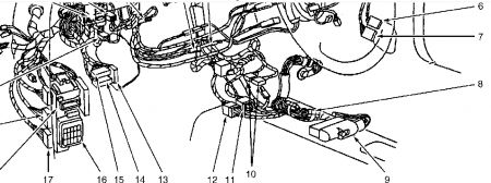

I’ve no clue where the PCM 104 pin connector is in order to disconnect it. Would welcome any direction finding it. I would really like to test that circuit fully to be sure nothing is shorted.
Voltage between Pin 83 (at the harness) and ground is measuring 0v. Resistance between Pin 83 and ground is 203 ohms

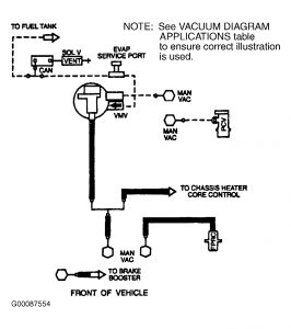

AIDAN_80
  • 41 POSTS

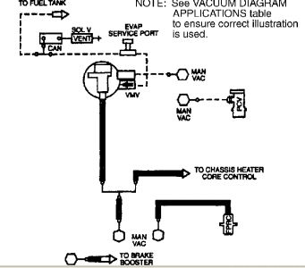

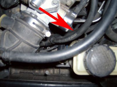

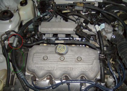

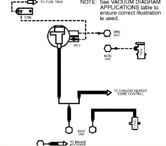

I checked yet again for vacuum leaks as I did find an area giving me a slight increase in idle when sprayed with carb cleaner.. I wanted to ensure 100% that nothing was cracked, open or rotted away..
I found see images below.. under the IAC the throttle body.. below that there is a tube that runs down and it's open on the other end.. it isn't connected to anything? When I sprayed carb cleaner on it the idle jumps when I closed the tube the idle drops then starts to come back up again very slowly?
Should this tube be connected to something or is it some kind of drainage tube?
The image was taken from the area highlighted by the red arrow, below the throttle body leaning over the battery on the right side of the vehicle.
Jan 31, 2009 at 8:36 AM
MERLIN2021
  • 17,250 POSTS
PCM 104 pin connector is at the center of the dash number 9 and I'm not sure about the vac line, but it should NOT be a dead end. There should be a decal with the vac routing on it, but heres one anyway...Any increase in engine speed means a vacuum leak and ALL must be repaired! The PCM cannot control mixture when unmetered air is entering the engine! Fix these and you will more than likly fix the problem.
https://images.2carpros.com/forum/automotive_pictures/62217_PCM_5.jpg
https://images.2carpros.com/forum/automotive_pictures/62217_vac_2.jpg
https://images.2carpros.com/forum/automotive_pictures/62217_vacb_1.jpg
https://images.2carpros.com/forum/automotive_pictures/62217_vaca_1.jpg
There are two different routings shown so here is both.
Jan 31, 2009 at 10:16 AM
AIDAN_80
  • 41 POSTS
Thanks again for the response! I think it may well be that vacuum line running out of the throttle body. I found the other end of the line and from what I've been told is connected back to the purge valve? I assume that the black item in the image below? The line looks like it's rotted away over time it's falling apart.
I got a new line and once I have some daylight tomorrow I'll install it and see if that helps. Any advice on installing it would be welcome. I'm not seeing any clamps holding it on I assume it's stuck somehow.. the original line looks like it was stuck to the plastic line that runs from the purge valve (black item) in the image below.
Jan 31, 2009 at 11:24 AM
AIDAN_80
  • 41 POSTS
I installed the new vacuum line from the bottom of the throttle body back to where the other broken end was. With the engine running, I sprayed the entire area again with carb cleaner and no changes in idle. I also pulled out the IAC power connector and right away the idle dropped very quickly but it adjusted itself before it stalled and settled into a shake once more. Reconnecting the IAC the idle corrected itself again and the shaking was reduced quite a bit.
I've cleared the computer just so I'm starting from fresh and so it'll relearn everything from the start. I'll drive it for a few days and see how it is. Even now it does feel a bit smoother than before although I can still feel the vibrations from the engine inside the car.
