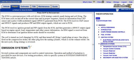

I have a 1997 Tracer with a with 180 thousand miles it stalled was able to get it started but ran rough I changed timing belt ,spark plugs, plug wires , still would start hard and run rough I checked for spark #2 & # 3 no spark I changed coil pack still no good A friend sugjested computer so I changed it still no spark. where do I go from here.

Could be faulty wiring, ignition control module and crankshaft positioning sensor-

I have the repair manual and have replaced the Crank shaft sensor but nethier has helped it looks as if this is a reocureing problem with this car there seems to be a lot of people on your list that have had the same problem

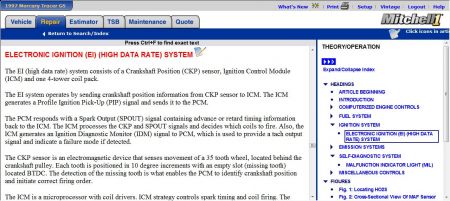

You need to double check the ICM and CPS
