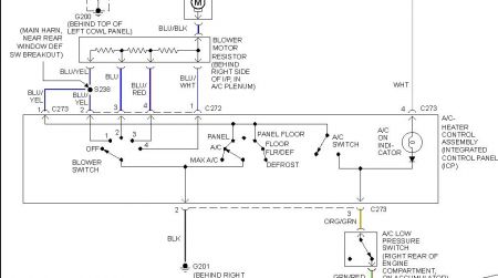

Alright, Basically, my heat, air conditioning...nothing works...there is a slight flow of air, not warm at all, but barely noticable. When I turn off the heat or air, I only hear a hiss sounds from the vents. This has happened before a few months back, but it magically began to work again and recently stopped...just in time for winter.
