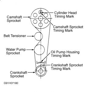

where are the timing marks on the camshaft?

https://images.2carpros.com/forum/automotive_pictures/261618_Graphic_306.jpg
