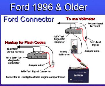

You need to ground the sti wire at the test connector then set timing to 9-11 BTDC
https://images.2carpros.com/forum/automotive_pictures/62217_Timing1_1.jpg
https://images.2carpros.com/forum/automotive_pictures/62217_Test_Connector_Pre96_1.jpg
