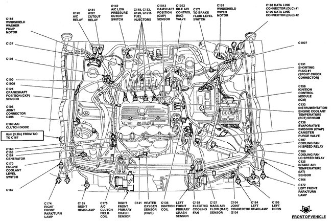

Where is the cooling fan sensor switch located ?
Apr 3, 2010 at 8:17 AM
  • 55,433 POSTS
Hello

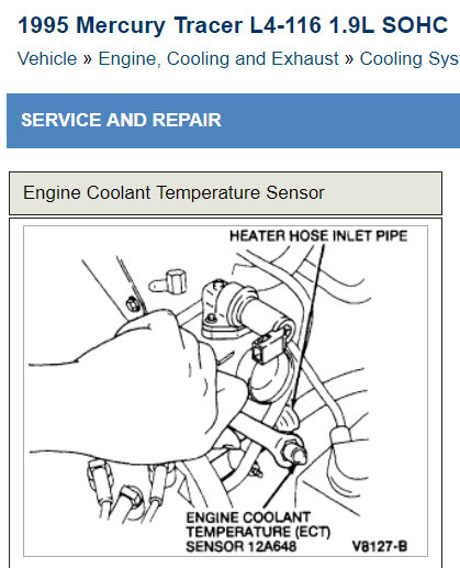

The coolant sensor is located on the cylinder head here a guide that will show you what you are in for when changing the coolant sensor out.
https://www.2carpros.com/articles/coolant-temperature-sensor-cts-replacement
Here is the location for your car
