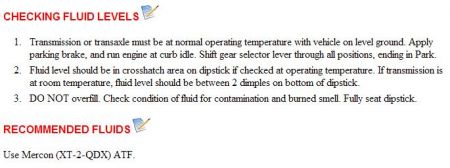

I have a 1994 mercury tracer. Could you please advise what type of transmission fluid I should use. Should my engine be warm to check fluid levels? and where the portal is for the transmisson fluid?

https://images.2carpros.com/forum/automotive_pictures/261618_Noname_1589.jpg
