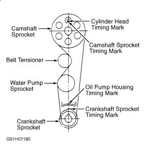

HI I NEED TO NO HOW THE TIMING MAKES LINE UP ON MY CAR NEED A PIC OR SOMETHING TO SHOW ME HOW TO LINE THEM UP THINKS

https://images.2carpros.com/forum/automotive_pictures/261618_Graphic_294.jpg
