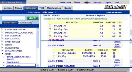

Sir-You have hydraulic valve lash adjuster and its not adjustable-fix by replacement the problem here this lifters rides on the camshaft lobes and they do get wear and tear that's why I mentioned camshaft replacement. Pull the valve cover and replace the adjuster don't worry about the camshaft You don't have to re-donate I will continue to help you but keep me posted what's going on with the repair See below quotes on labor and parts
https://images.2carpros.com/forum/automotive_pictures/12900_adjusters_1.jpg
