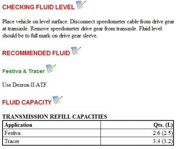

I cracked my thermostat cover and there are none available. I know the madza 323 is interchangeable, but where is the thermostat on the madza. Aslo how do I add trani fluid to the tracer?

follow upper radiator hose to engine block to locate thermostat on the 323..
https://images.2carpros.com/forum/automotive_pictures/261618_0900c1528004e7c0_1.jpg
https://images.2carpros.com/forum/automotive_pictures/261618_Noname_2212.jpg
