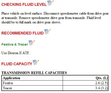

I cracked my thermostat cover and there are none available. I know the madza 323 is interchangeable, but where is the thermostat on the madza. Aslo how do I add trani fluid to the tracer?

follow upper radiator hose to engine block to locate thermostat on the 323..
