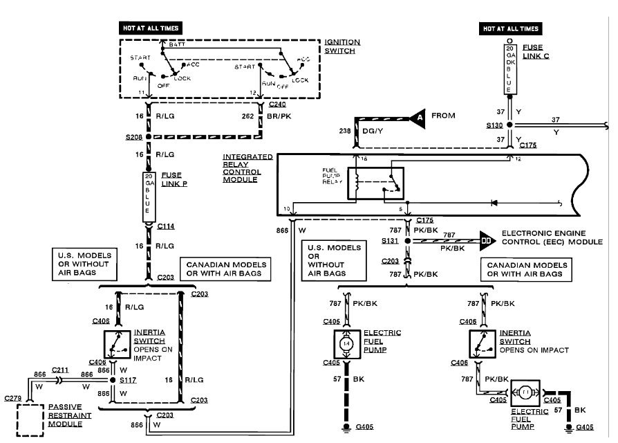

Where do you find the fuel pump relay and the fuel pump relay fuse on the Topaz, I bought this fuse and it looks like a little black box that supposed to plug into something but I don't know where it is????
May 31, 2009 at 10:09 AM
  • 55,554 POSTS
Hey TONY,
The relay is inside of the TICM here is a wiring diagram and a guide so you can do some testing and get the problem fixed.
Please let us know happens so it will help others.
Best, Ken
