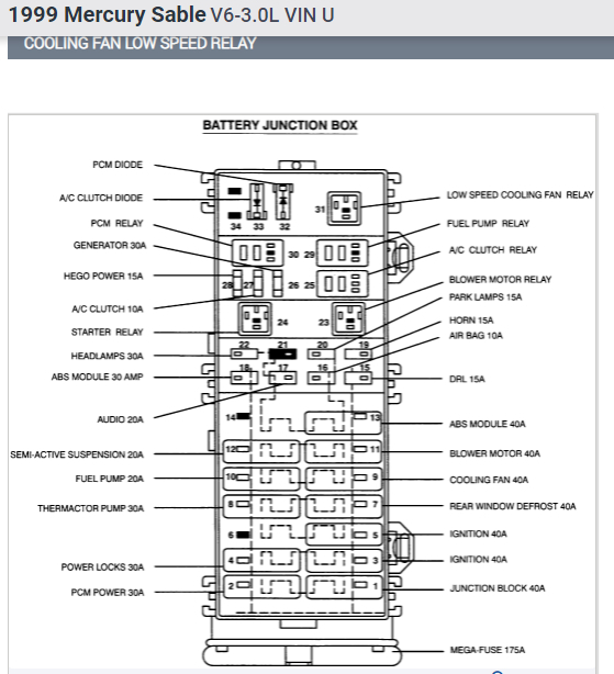

indicator shows the car is warming up?
1999 MERCURY SABLE STATION WAGON
BURCH13326
The heater indicator shows the car is warming up. When I start going faster the gauge drops back to cold again. I know the heater core is bad. I my problem part of the heater core?

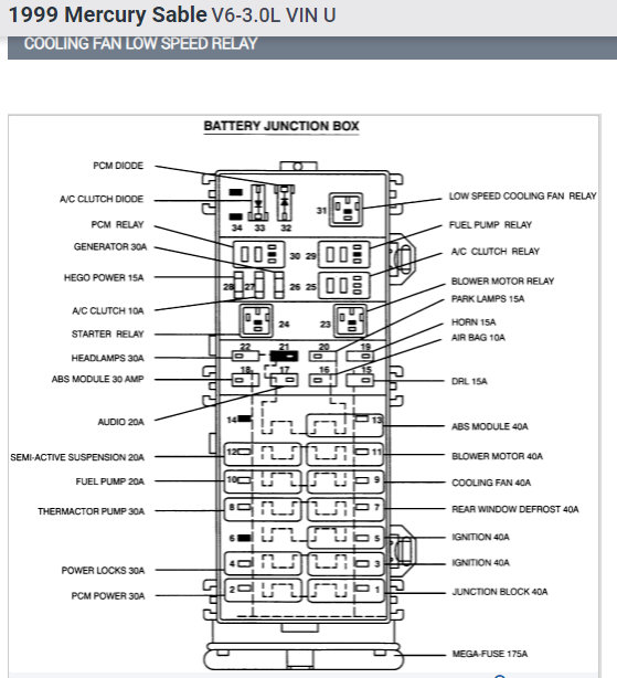

This sounds like you might have an issue with the radiator cooling fans.
https://www.2carpros.com/articles/symptoms-of-an-overheating-engine
When you are at stop there is little to no air blow thru the radiator as the fan might not be functional, so the engine overheats, but as you drive the air get through the radiator and cools down the engine.
https://www.2carpros.com/articles/how-an-electric-cooling-fan-works
Check to see if the fan is coming on when the engine is at operating temperature and running. An inoperative fan can be due to a bad fan relay, wiring or a bad motor. It can also be caused by a faulty coolant temperature sensor. Where the sensor does not provide the correct signal to turn on the fan.
First check the relay. It is located under the hood in the main fuse box (see diagram).
Visually inspect the relay for corrosion or bunt pin(s).
You can also test the relay as well:
