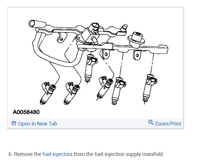

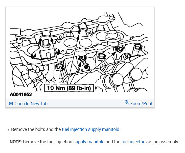

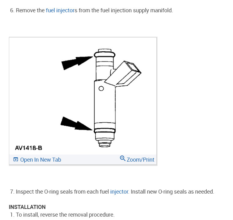

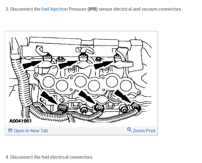

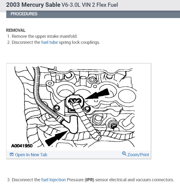

The sound would be good to hear, can you please shoot a quick video with your phone so we can hear the noise? That would be great. You can upload it here with your response. But it sounds like you have a fuel injector that is shorted or stuck open. When you replaced the spark plug, did you notice one of them back or wet with fuel? Here is how to test the injectors and remove them for replacement:
https://www.2carpros.com/articles/how-to-test-a-fuel-injector
and
https://www.2carpros.com/articles/how-to-replace-a-fuel-injector
Here is how to do the job on your car. Check out the diagrams (below). Let us know what happens and please upload pictures or videos of the problem.
