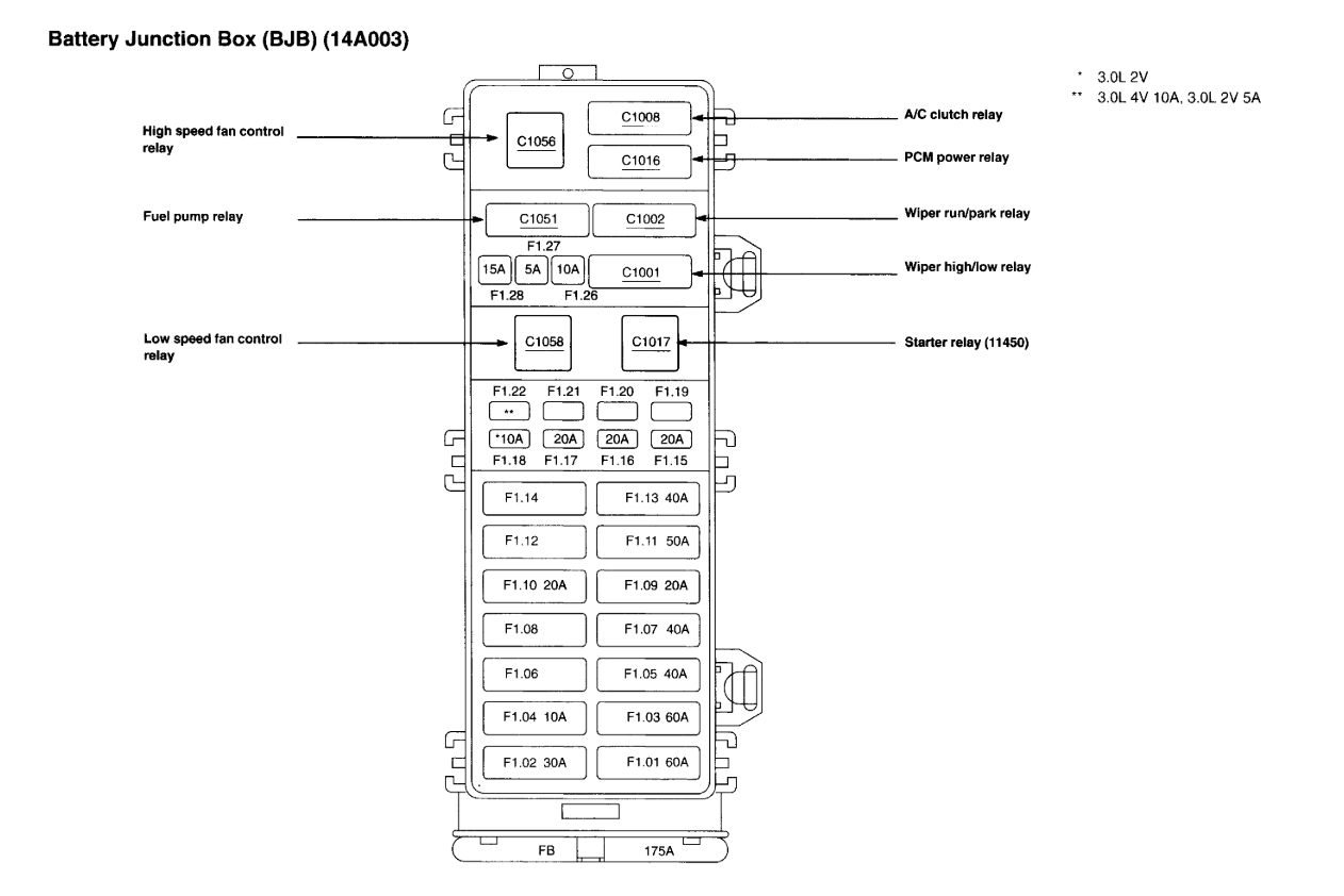

I sent my Mercury Sable to the shop and they told me something was wrong with the starter relay. Where is the starter relay in the Mercury Sable? I want to try and fix in myself.

Here is a guide to help you test the relay with the relay location below.

Were is starter relay car will start than not start
Jun 8, 2019 at 10:04 AM (Merged)
sounds more like the actual starter motor. have it checked but i think you will find the starter motor failing
