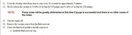

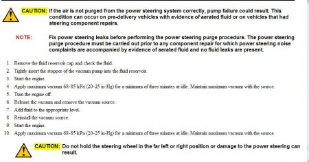

How do i puge the power steering system
Aug 24, 2008 at 9:57 PM
OBXAUTOMEDIC
  • 3,711 POSTS
Hello, You will need a vacuum tester with reservior.....
https://images.2carpros.com/forum/automotive_pictures/188069_05sableseerpurg1_1.jpg
https://images.2carpros.com/forum/automotive_pictures/188069_05sableseerpurg2_1.jpg
I will email the pics for easier viewing..
