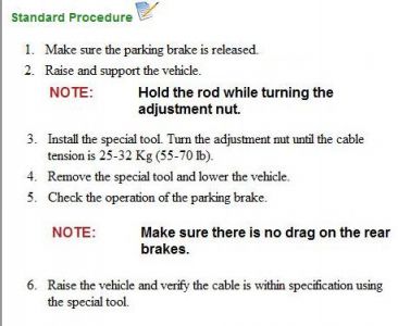

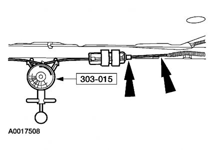

I have a 2005 mercury sable that failed inspection due to me driving with parking brake on and it caused it to slip for inspection. What i need to know is where to look and what to do to fix the adjustment on it under the car.

hello and thanks for donating the adjustment steps for your vehicle's parking brake are below.
https://images.2carpros.com/forum/automotive_pictures/261618_Noname_2425.jpg
https://images.2carpros.com/forum/automotive_pictures/261618_Graphic_600.jpg
