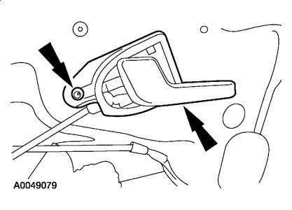

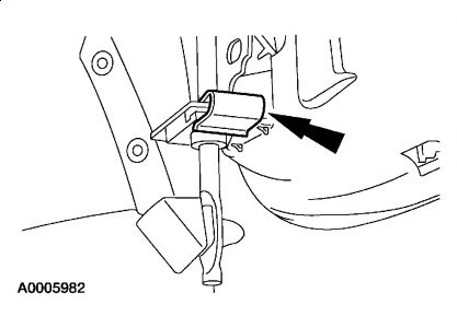

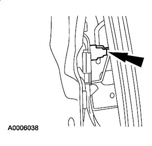

The keyless entry keypad (on the door, not the remote) on my sable has a bad button. Is there a way this can be repaired or replaced, and if so, is it easy to do yourself, or would it need to be repaired by a pro?
Mar 7, 2009 at 9:46 PM
BMRFIXIT
  • 19,053 POSTS

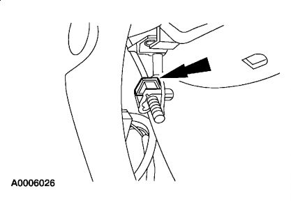

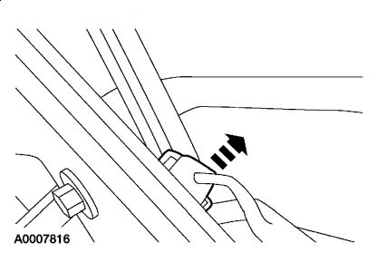

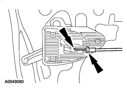

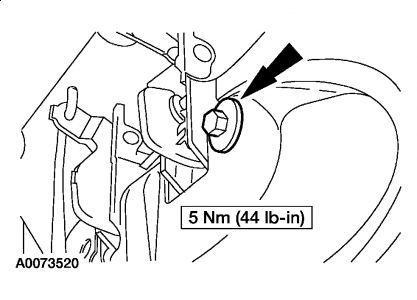

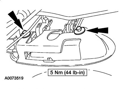

its not an easy job 1.Remove the front door trim panel 2.Position the watershield aside. 3.Disconnect the exterior door handle actuating rod from the door latch. ? Open the clip. 4. disconnect the electrical connector on keyless entry keypad 5.Remove the bolts and exterior door handle. 6.remove keyless pad 3 nuts 7. remove and replace keyless pad
