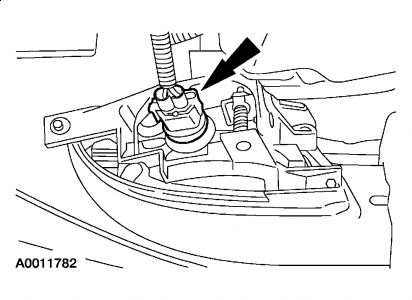

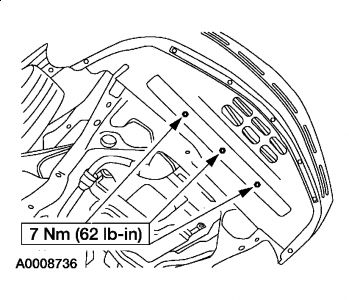

I need to replace the foglight bulbs on my 05 Mercury Sable. I was suprised that there isn't a section on it in my owners manual. Can someone give me a guide/walkthrough on how to change them?

Ok here is how you replace it. First raise the front of the car enough for you to get under it. Now remove the aeroshield and then you can see the back of the fog lamp now unplug it and remove the bulb and replace it. Aeroshield
https://images.2carpros.com/forum/automotive_pictures/249564_Graphic_207.jpg
unplug bulb
