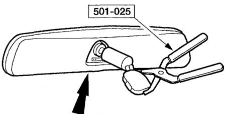

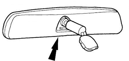

My electronic inside rearview mirror is loose. I remove the square cover and expose the small circuit board, but I don't see any screws or other means of tightening the mirror.

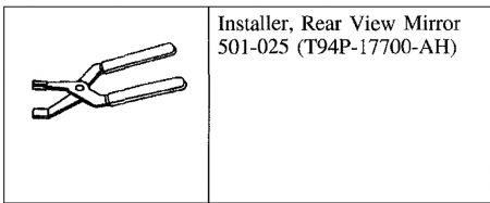

There are none! This has a breakaway mirror, and it only is replaced. Here's how:
Removal and Installation
CAUTION:The interior rear view mirror is of the breakaway design. Excessive force in any direction will cause damage to the mirror.
1.Remove the interior rear view mirror.
à   Insert a small flat-blade screwdriver into the slot at the base of the mirror. Hold the mirror and pull the screwdriver rearward until the mirror snaps off the interior rear view mirror bracket.
Fig. 35: Removing Interior Rear View Mirror
Courtesy of FORD MOTOR CO.
2.Using the special tool, install the interior rear view mirror.
