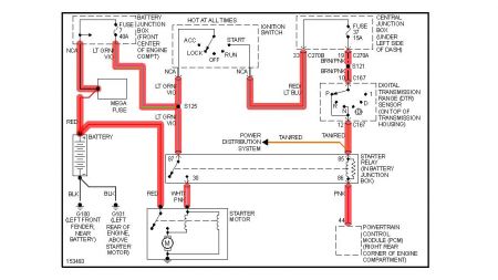

HOW DO I CHANGE THE STARTER. WHEN I TRY TO START MY CAR IT WANT TURN OVER,I HAD THE BATTERY CHECKED AND IT WAS FINE.

Better check 1st if you have a problem with the Mega fue/fuse no.7 and no.37 ignition switch/transmission range sensor/starter relay before you get to the starter- Do this have helper hold key at crank position and you go look for power at the white and pink wire at starter-do you have it? If not see below -If so-replace the starter.
https://images.2carpros.com/forum/automotive_pictures/12900_sable_1.jpg
