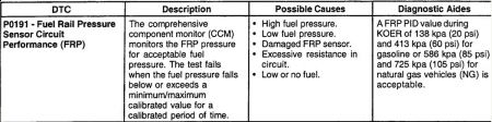

IF they charged you and did not test drive during likely conditions if they were instructed to do so, then you have a good gripe.
On the shop's defense of strategy, not the charges if any, they are trying to nail down the problem in the most likley situation from their perspective of experience, facts and troubleshooting data. When you have an intermtitant problem that is as infrequent as yours, another strategy may be needed.
https://www.2carpros.com/forum/automotive_pictures/30961_0m_1.jpg
Process of elimination for what facts we have.
Low fuel or no fuel.
Have you done this? What the specification of low fuel is, I'm not sure. I'll see what I can find.
High pressure or low pressure can ONLY be determined by catching the problem with the fuel gauge on. You may need to buy a gauge (https://www.2carpros.com/store/index.php?main_page=product_info&cPath=10&products_id=16) and have them hook it up to the windshield or some way of viewing it while you drive it. Then you can tell if the pressure goes high or low. Just be sure to verify from a seller that it will work with your vehicle and that any adapters are included. If I had to put money down, I would be suspecting a pump that is losing pressure for that period of time.
The shop can check the resistance in the circuit.
The shop should have already looked at the sensor and evaluated it for damage and the harness as well...BE sure to ask them if they did. IF they didn't, have it looked at.

BMRFIXIT stated replace fuel pressure regulator or reprogram PCM. What does PCM stand for?
I do not find the response from Service Writer Posted: Fri Oct 30, 2009 4:05 pm of any help.
Low or no Fuel? I stated that each time I was able to drive away after waiting 15 minutes.
Buy and install a fuel gauge to confirm what the code 191 already tells me. How does this pin point what to fix. Fuel pump failure is normally total and not intermittent over such a long period isn't it.
Circuit resistance? Would not be so infrequent and not only under these specific conditions?

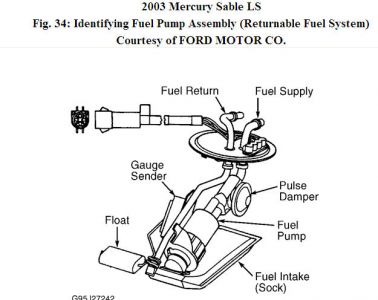

Does that leave the sensor as the most likely problem. Is the sensor replaceable without accessing the fuel pump in the gas tank?
Friday, October 30th, 2009 AT 11:07 PM

Fuel pump failure can most certainly be over a period of time and intermitant. It may be weak giving fuel presure that is low but present. As opposed to a "no volume of fuel ", it can have a "low volume of fuel. Conversely the fuel pressure may be too high ( fuel pressure regulator)
I brought up the possible sources according to Mitchell One. Since this is intermittant and it is your problem you want help with, you need to decide which way to pick at it. I gave you ideas and my recommendation to catch it. Since this happens approximately once every 20 days, testing may not be so simple as one pinpoint test.

This fuel system system is a returnable system.
https://www.2carpros.com/forum/automotive_pictures/30961_0c_1.jpg
Therefore the FRP sensor is not in the tank.
BMRFIXIT stated to "Check" the regulator first, not replace it first.
