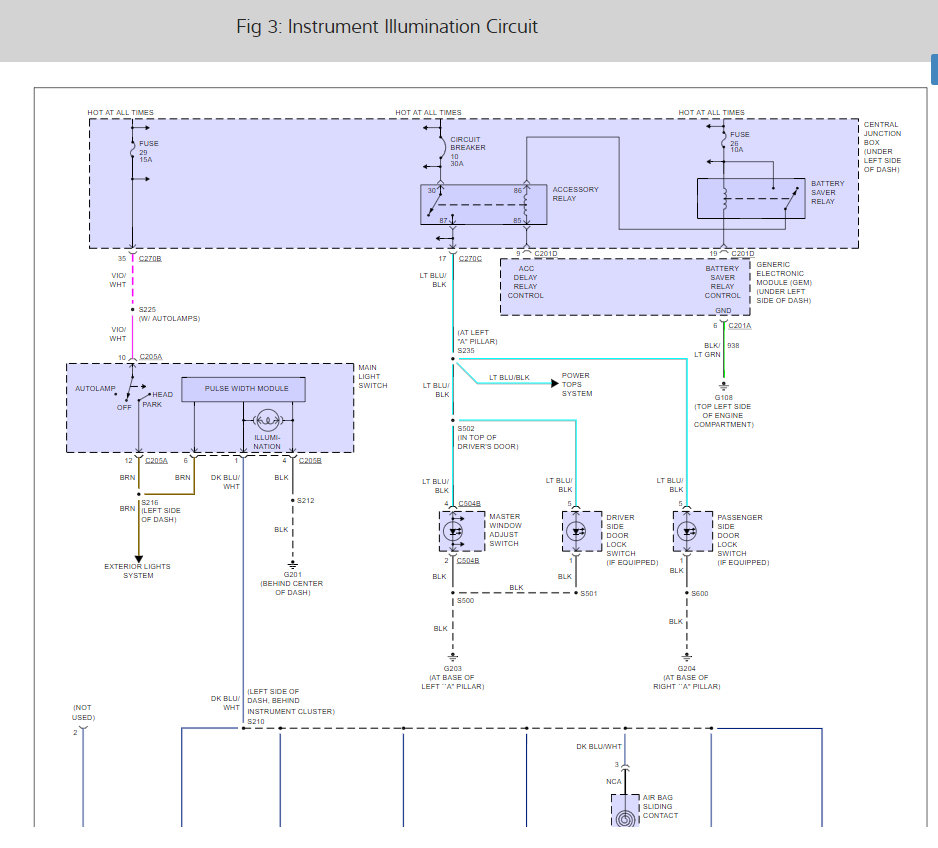

when i turn on head lights, the inside dash board lights do not turn on, is this a wiring problem or hopefully a fuse replacement?
Jan 15, 2010 at 12:16 PM
BMRFIXIT
  • 19,053 POSTS

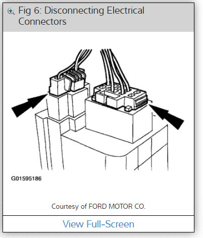

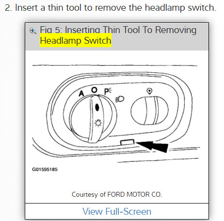

It sounds like you need a headlight switch but to be sure check for power coming out of the dark blue and white tracer wire from the headlight switch.
Here is a guide and the headlight wiring diagram to confirm the failure.
Cheers
Jan 17, 2010 at 7:05 AM
TCOLLINS12
Thanks for the guides I tested the headlight switch and it was bad so I replaced it now all the lights work. Thanks I love this site.

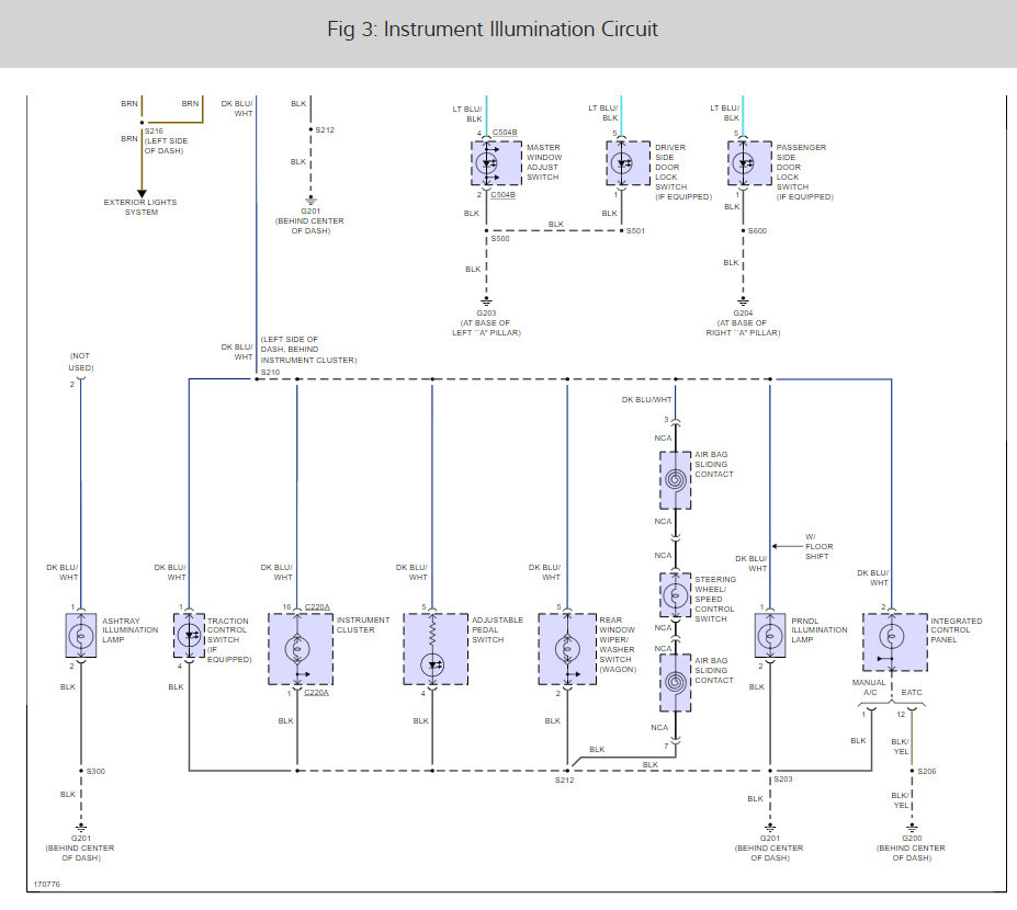

my dashboard lights sometime work and sometimes dont work. I dont think its the light switch since the lights go no at the radio and other controls. When the dash lights are out the two driectional lights stay on, unless I activate the directionals or 4-ways.
Aug 6, 2019 at 3:22 PM (Merged)
BMRFIXIT
  • 19,053 POSTS
Its a mater of checking and locating a short or a loose connector
overheated wire will cause the same too
i would start with the light switch and its connectors
JBFINCH
I have a 2001 Sable with an identical issue. Have not traced wires yet, but suspected a bad connection somewhere. fun fun.
FRUGAL1
The problem was with the circuit board behind the speedometer cluster. You can change just the circuit board which I purchased from Ford. It was time consuming for a do it yourselfer but everything is working now.
