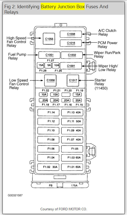

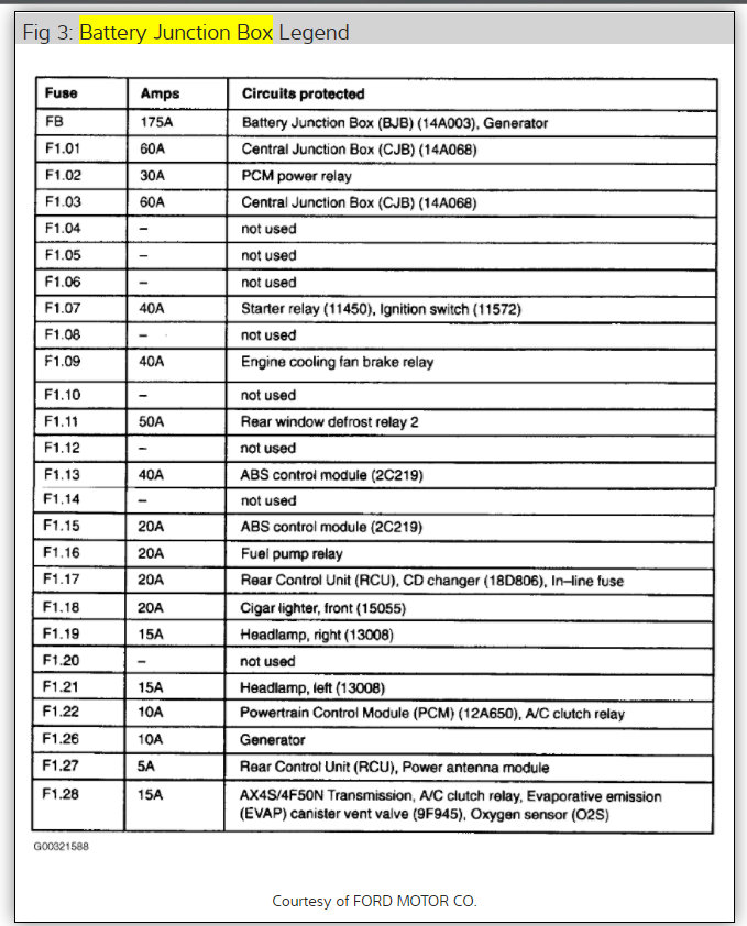

let's start by load testing the battery and alternator these guides should help us fix it.
and

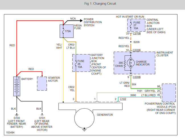

We need to check for power at the fuse # 27 here is a guide to help us and the alternator wiring diagrams so you can see how it works and the fuse location as well.
Check out the diagrams (Below). Please let us know what you find. We are interested to see what it is.

Yep you nailed it the fuse was blown, thanks for this psopt I love this site.
