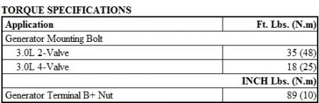

What are the altenator tourque specs on a 2002 mercury sable?

Jul 1, 2010 at 9:50 AM
